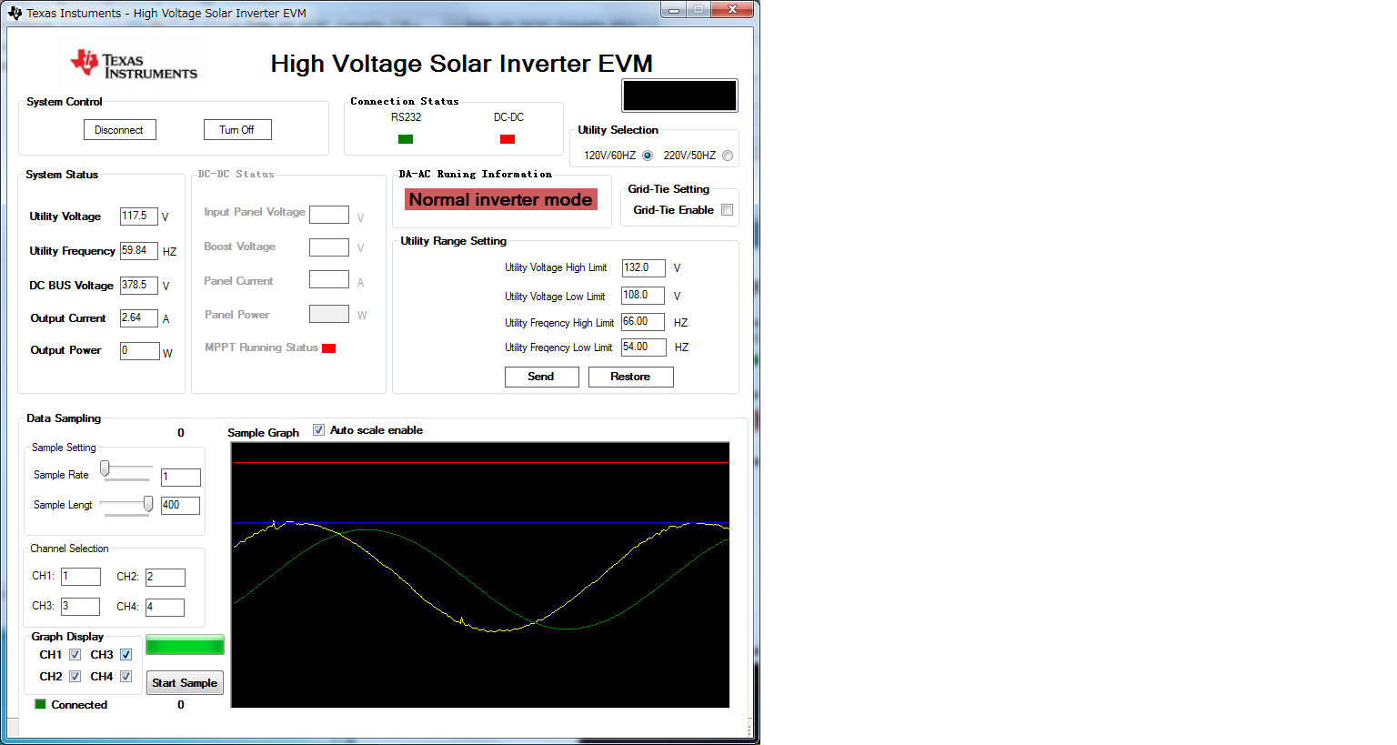

I installed TMDSHV1PHINVKIT as follows,
-Build c28 and m3 project files in ControlSUITE by using CCSv6.
C:\ti\controlSUITE\development_kits\HV_SOLAR_DC_AC_v1.1\Solar_HV_DCAC_Concerto_SCI_Rev_0
\C28 --> C28x project
\m3 --> m3 project
- These two .out files were burnt into both FLASH memories by CCS.
- Invoke the GUI
AC120V output was good. Both the AC output voltage and the Frequency were good.
But 220V Operation was not good. The AC output voltage was only 134V as the result.
Could you please tell me how to generate the correct AC voltage on the GUI "Utility Selection AC220V/50Hz" mode?
Do I have to change anything above C28/m3 source files?
