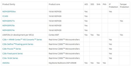

Hi
I would like to encrypt data and decrypt it using the AES-128 .
I find that this program does not work for me when using F28377xD . It returns junk values . Ti has AES-128 for msp430 as given in the below link . Can I use this for my device as well ?
   http://www.ti.com/tool/aes-128
Kind Regards
Anish
  • Hi Anish,
    Here's the table that would give you a clear picture:
    Hence the code does not seem to be compatible with C2000 devices.
    For more info you can refer: http://www.ti.com/ww/en/embedded/security/index.shtml
    Gautam

  • Hi Anish,
    AES-128 will work with C2000. However, C2000 does not support support truly 8-bit data types. You shoud have to do some bit-masking in your galois_mul2(value) function.
    You ca try this...
    // multiply by 2 in the galois field
    unsigned char galois_mul2(unsigned char value)
    if (value>>7)
    return (((value << 1)^0x1b) & 0xFF);
    } else
    return ((value << 1) & 0xFF);
    OR make this change to the galois_mul2() from the link you are using.
    return (((value << 1) & 0xFF) ^temp);
    sal
