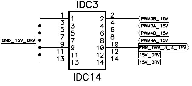

I am using 1-A, 1-B, 3-A and 3-B as the ePWM ouputs. So I am using both the 14-pin ePWM outputs in the hardware, which are connected to each of its MOSFET driver IC (whose picture I have uploaded).
I can see U22-MIC4468ZWM, a MOSFET driver IC before the 14-pin PWM output in the DSP TMS320F28335. I am working on a simple ePWM module in the DSP. My aim is to get 4 PWM pulses from the 14-pin PWM output in the hardware.
 I am getting the desired output as I have programmed, according to my requirements in the pins--> PWM1A_3.3V, PWM1B_3.3V of MOSFET IC driver 1 and PWM3A_3.3V, PWM3B_3.3V of MOSFET IC driver 2 respectively . But not in the pin PWM1A_15V, PWM1B_15V, PWM3A_15V and PWM3B_15V.
So in order to get the ouputs in the 15V pin of the MOSFET driver IC, I have to enable the PWM_ENABLE_1_2_3.3V pin in the DSP itself whose pin configuration are as follows:
  PWM_Enable_1_2_3.3V ---> 21 (Pin number) ---> GPIO12
  PWM_Enable_3_4_3.3V ---> 27 (Pin number) ---> GPIO16
Finally my aim is to enable or set GPIO12 and GPIO16 pins to 1, for which I have included the following codes in the main()

After doing all these, I am still unable to set the GPIO12 and GPIO16 to 1 and thats my problem is concerned with
Question 1: What should I do the configuration of TZ (Trip zone) in these pins i.e. GPIO12 and GPIO16. Is it necessary to configure it as TZ1 and TZ5 in the DSP2833x_EPwm.c file as shown below  ???? or not to configure so that I can comment this line in DSP2833x_EPwm.c
GpioCtrlRegs.GPAMUX1.bit.GPIO12 = 1; // Configure GPIO12 as TZ1
GpioCtrlRegs.GPAMUX1.bit.GPIO16 = 3; // Configure GPIO13 as TZ5
Question 2: Is there any mistake in the codes I am using to enable GPIO12 and GPIO16 ?? Or is there anything I have to concern about when enabling these to pins in the DSP ?? Or any other changes I have to make in DSP2833x_EPwm.c file in order to set the GPIO12 and GPIO16 pins to 1.

    Seems that your purpose is to make GPIO12 and 16 as GP outputs.
    In this case you need to set:
    GPADIR into 1 (output)
    GPAMUX into 0 (gpio)
    and if you want to disable the pullup, GPAPUD is set into 1 (0, means enabled, is the default).
    And don't forget to put EALLOW and EDIS before and after the setting.
    Hope this helps.

    1. The settings of GPIO12 and 16 are ok except GpioCtrlRegs.GPAMUX1.bit.GPIO16 = 0;
    I think it should be GpioCtrlRegs.GPAMUX2.bit.GPIO16 = 0;
    Please check the datasheet to make sure.
    2. I don't know what inside your DSP2833x_EPwm.c.
    You can put the settings (GPADIR, GPAMUX,GPAPUD) anywhere before the main loop (but after the init base address if used) and make sure these settings are not overlapped by existing settings (that maybe exist before, maybe in InitEPwm1Gpio() and InitEPwm3Gpio()).
    And actually you can put these settings in InitEPwm1Gpio() or InitEPwm3Gpio() and call the function before main loop.
    About GPASET, you can put it anywhere after this setting based on your purpose.
    Maria

  • Dear Miss.Marisa,
      Thanks a lot for your prompt explanation.
      Now its working. As I am a beginner, I am learning slowly.
      Thanks once again !
