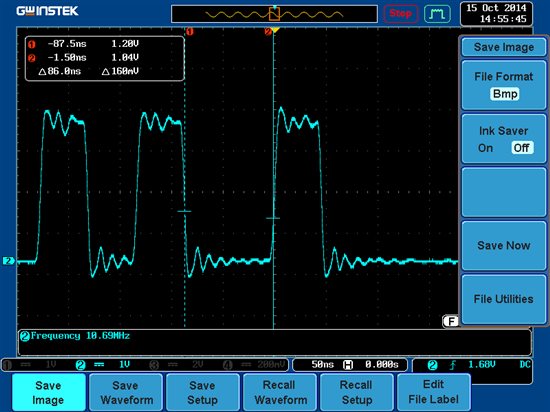

I am encountering something that is a bit baffling and am hoping someone could clarify.
I am running a bit of code in an interruption and it is taking longer than I am expecting to execute when I check on my oscilloscope I also checked using the clock feature in debugger mode to see how many clock cycles it is taking to execute an instruction, which I have included in the comments. This is the code in question:
// Interrupt routines uses in this example:
#pragma CODE_SECTION(epwm_timer_isr, "ramfuncs");
interrupt void epwm_timer_isr(void)
//EPwmTimerIntCount++;
GpioDataRegs.GPBTOGGLE.bit.GPIO32 = 1; //1 cycle - 49ns
aux = GpioDataRegs.GPCDAT.all; //3 cycles - 86ns
// Clear INT flag for this timer
EPwm1Regs.ETCLR.bit.INT = 1;
// Acknowledge this interrupt to receive more interrupts from group 3
PieCtrlRegs.PIEACK.all = PIEACK_GROUP3;
I am running this code off of RAM after transferring from FLASH. I also checked running only from RAM and the behavior is the same. I have also checked putting that bit of code directly into the main loop and disabling the interrupts and the behavior is the same. I would expect to see the time it takes to toggle on and off that pin should be about 7ns. Can anyone help me figure out what may be going on?
