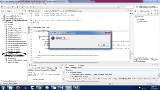

  • Hi
    I am attaching here a text document for a program to generate pulse using CPUtimers.

    I tried doing what you suggested.But I am unable to add delay.asm file in the program.S ee the attached screenshot.
  • Hi Sneha,
    1 The file DSP2833x_usDelay.asm is presented at your project already and you can use DELAY_US macro now. Look at your screenshot carefully:
    2 I suspect this thread will useful for your issue.
    Igor

  • Hi Igor
    Thanks for pointing out.
    It's working now.
