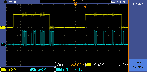

Hello All,
I am using TMS320F28069 with AD1938.
I am using the McBSP along with DMA to get the TDM8 data from AD1938 & sent back after processing.
The AD1938 is configured as Master & the lines CLKX, FSX, CLKR and FSR are driven by AD1938.
The data received on the McBSP port looks random when I dump & plot the data.
Could any one confirm the if the Initialisation of McBSP is fine?
Data is 24-bit format with 32 BCLK from AD1938.
