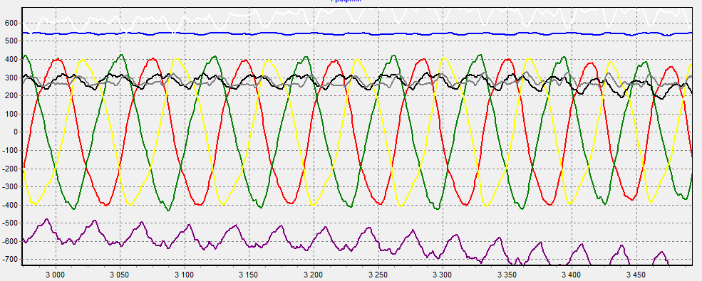

Hello!
May be ,anybody advise me soft example for c2000
compensation 3 fase inverter?
Dmitry.

it is not included with the InstaSPIN projects. It is not useful for low deadband drivers like DRV8301/DRV8312 in low voltage applications. It can be required in high voltage applications with large deadtime.
an example is shown in
C:\ti\controlSUITE\development_kits\HVMotorCtrl+PfcKit_v2.1\HVPM_Enhanced_Sensorless_2803x
which uses the PWMwDBC driver
documented here
C:\ti\controlSUITE\libs\app_libs\motor_control\drivers\f2803x_v2.1\~Docs
BTW - to make this extra confusing, the driver file does not change, it is still called just f2803xpwm.h but the DBC elements have been added
