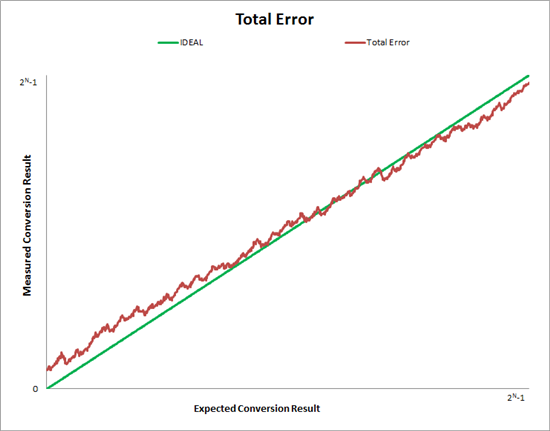

I am using Rev B silicon and have implemented most (if not all) of the ADC-related fixes in the Errata.
When running the code, there are values in the ADC offset registers on both modules so I know that the offset functions are running.
However, if I put a regulated 1.634V signal on any pin, I get a bad offset.
Using the internal voltage reference:
I should get 1.634 / 3.3 * 4096 = 2028, but I get 2012 or so.
Using the external reference (custom board, regulated supply):
I should get 1.634/3.27 = 2047, but I get 2032 or so.
This behavior is exhibited on at least 3 separate boards and the input voltage was measured by multiple separate meters.
Here is some data after 60 seconds of capturing ADC results at 2kHz, using an external 3.27V reference, and sending them over CAN:
1.634V (ADC1A2) -Average: 2032.138032
1.634V (ADC2A2) -Average: 2032.236417
1.635V (ADC1A4) -Average: 2033.18649
(Std Dev < 1 count for all 3 channels)
Below is the ADC Init code:

  • Hi Will,
       What is the ADC clock speed?
      - Rick
  • Hi Will,
         How often are you running the offset calibration?
    - Rick
  • William,
    It would also be good to get conversion results at another voltage, say something near full scale but not saturating the conversion at 4095.  This will help separate how much of the error is from offset (consistent throughout input voltage range) from gain (increases with increasing input voltage).
    Joe

    Also, I was able to do a sweep with the same code on a controlCard (internal voltage reference):
    Voltage Expected ADC Actual ADC Error
    0 0 0 0
    0.4 496 447 49
    0.8 993 954 39
    1.21 1502 1461 41
    1.61 1998 1968 30
    2.01 2495 2471 24
    2.41 2991 2975 16
    2.82 3500 3479 21
    3.22 3997 3982 15
    3.3 4095 4082 13
    3.31 4095 4091 4

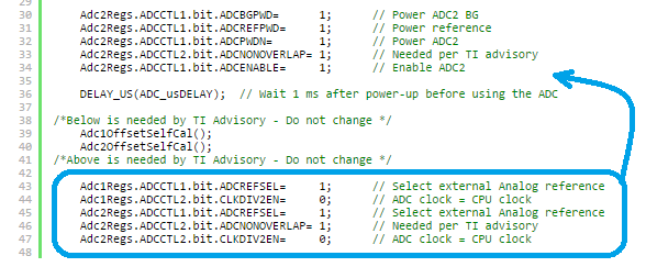

  • William,
      Thank you for the additional information.  Based on the control card data there does appear to be an offset error of about -45LSB.
    While I work on getting someone to replicate your setup, I wonder if you could try moving the offset self-cal routine after the code which sets up the reference mode.  I would not expect it to make a big difference but just want to make sure.
    Also please make sure DeviceCal never executes after the self-cal runs.  It was a good deduction that self-cal is running by viewing the register contents, but DeviceCal may be storing a factory trim used for test purposes so non-zero register contents may not be enough to prove the self-cal is not getting overwritten.
    Lastly for our setup replication can you provide the ACQPS values used?

    After confirming with a global search, Device_cal runs twice total. Both snippets are detailed in the original post (it should probably be cleaned up, actually, I am not sure that the first call does anything at all.  It was a copy paste from an example project)

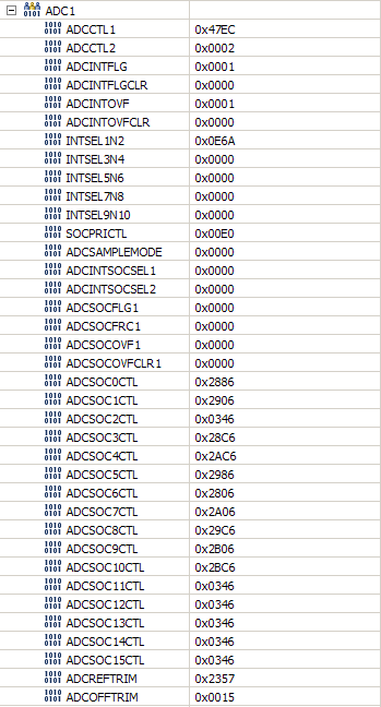

    Also, I have confirmed during run-time that there are non-zero contents in the Factory TRIM register.
    All of the channels are ACQPS = 6, most are PWM timer triggered (even duplicating the first conversion due to the Advisory).
    To verify most of the above, I have attached a screen shot of the ADC1 contents at about 10 seconds after startup.
  • Thanks William,
    I would suggest moving all the ADC config code before the DELAY_US instruction and then remove the REFSEL instruction form the ADC self-cal routine.  That will ensure that the offset is calibrated using the ADC configuration used in the system and also makes sure the reference has settled before any conversions take place.
    Again, I don't expect this will have a large impact on offset necessarily, but I think it would be good practice.
    BTW where is InitAdc1/2 called with respect to InitSysCntrl?
  • During my debugging path, I made a copy of the Adc1OffsetSelfCal function and removed the ADCREFSEL line as you have mentioned, no luck. However, this code is provided by TI, so I assumed that it worked and quickly reverted. If it is good practice, and I agree, perhaps TI could provide the code this way?
    InitSysCtrl is first, InitADC is some time later.  Both are called only once on their way to an inf loop.
    EDIT:  I changed the code to the order that you suggest and re-enabled the offset function without the refsel and there was no notable difference (2-4 counts, but mostly due to DC supply accuracy - I am using a POS).

    Every single ADC Channel is being used (go hard or go home, I'd say).
    VSSA1/2 are directly connected to ground.  The reference signal is actually made by a TI Part too.  :D
    Also, could you maybe try v204 and see if it even works on your setup?  Maybe the fact that mine grinds to a halt immediately (as described in my other thread) is related?
  • William,
    No appreciable difference V201 vs. V204.  Also I measured the voltage a little closer to the DUT, so offset was 5LSB/6LSB respectively.
    I'll keep plugging away.
    BTW I had no problem with V204 adc_soc once I switched the build config to RAM instead of FLASH (default).

    I will give you some values from our project.
    After running the ADC Offset Calibration (128 samples) the values of the OFFTRIM registers are ~7 for ADC1 and ~13 for ADC2.
    To measure values between +-10V we are using external reference voltage. After Offset Calibration I measure 2040 (ADC1)  resp. 2035 (ADC2) instead of 2048 for the 0 reference value.

  • Hi Matthias,
                    Thank you for your system results.
                    It seems both you and William have a system which is sampling a signal based on a ±10V range scaled to the ADC 0-3.3V range.  One thing to point out is that the voltage you consider 0 reference point is actually a mid-voltage for the ADC.  That means error seen at that voltage cannot be attributed to offset alone.

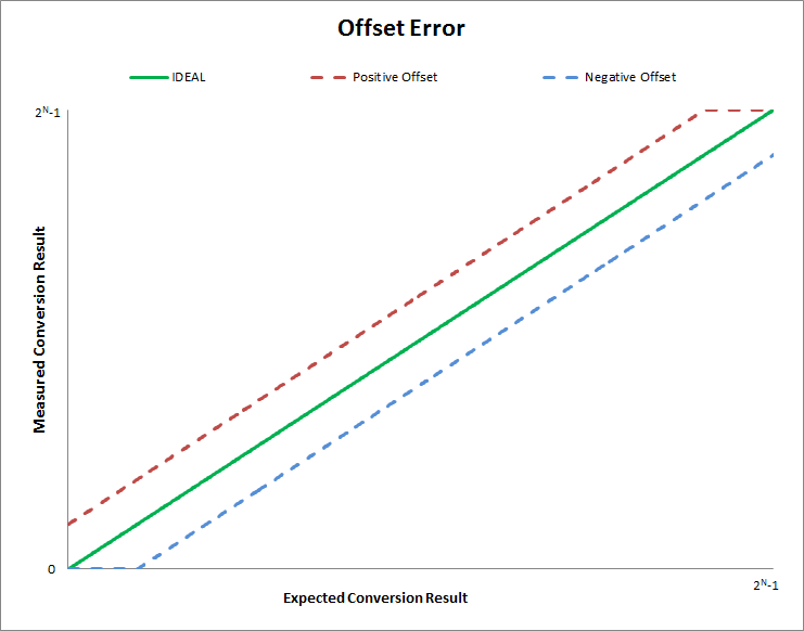

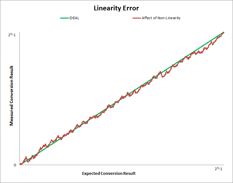

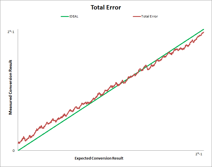

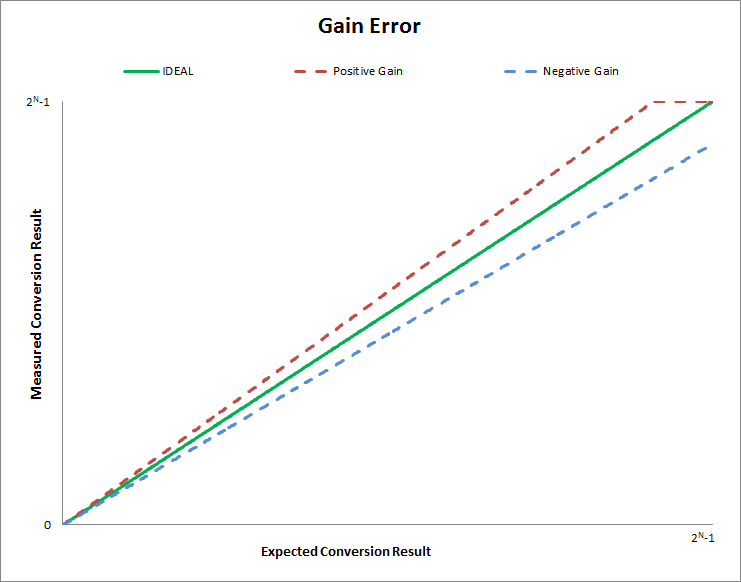

                    In fact let’s break down the main sources of error spec’d in our DS.
    Offset error is a factor that is consistent throughout the ADC voltage range and can be positive or negative.  Please note I have exaggerated the error components well beyond our DS so they will be visible on the following plots.
     Gain error is a factor that increases linearly with increasing ADC input voltage and can be positive or negative:
    INL is a measure of the linearity of the conversion results across the input range of the ADC or put another way the deviation from the ideal after offset and gain error have been removed:
     While
    C2000 does not specifically spec Total Error in our DS, ultimately all these sources of error interact to affect the ADC.
    Simply adding the DS specs for gain, offset, and INL is a bit pessimistic since those specs are guaranteed over the normal operating range of the device and it is not likely that they will all be worst case simultaneously.  We have sometimes suggested using a square root of the sum of squares method to approximate.
    In any case, given conversation results at a single voltage point, it is difficult to separate out the sources, but based on our DS specs, gain error is typically going to dominate.  Note: gain error is spec’d at worst case input voltage (which is the max input voltage).  For a lower voltage the spec should be scaled, for example an input voltage of 1.65 could see (1.65/3.3)*60LSB = 30LSB error for internal reference mode or (1.65V/VREFHI)*40LSB for external reference mode.
    All this to say that without more information I suspect your ADC is operating within DS limits.  If the amount of error you are seeing is greater than your system can tolerate then we can potentially discuss a calibration method that might improve the gain accuracy to some degree though usually at some cost, namely you must use external reference mode and also provide a precise reference voltage to calibrate to, and TI doesn’t guarantee performance when using such methods.
    I hope this information helps, please let me know if you have questions.

  • William,
    Where are you sampling the voltages in the attached table (at the ADC input pin where they are 0 to 3.3V range, or at the input to the signal conditioning circuitry where they are in the -10 to 10V range)?
    What instrument are you using to measure the voltage? Is the voltage DC?
    The next step would probably be to integrate the self-calibration procedure into your sampling code. (not the self calibration function, but the underlying procedure of sampling the internal REFLO connection, then adjusting the offset error)
