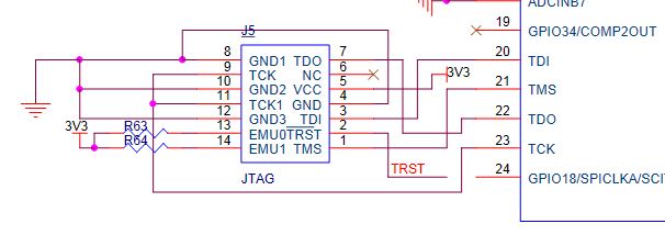

    You can purchase a XDS100v2 emulator which is very economic. On your board you can bring out the JTAG connections to a connector, something like this:
    Then you can use the XDS100 emulator to program every board.
    Gautam

  • Sounds like a good solution.  From C2000 documentation, it looks like it uses a 5 pin connection.  On the link you sent I saw that there are emulators with a lot more pins, but it seems that the 14 pin version is the recommended one and that DigiKey part MHB14K-ND is our connector.  Given all the extra pins, I'm assuming that I can leave those unconnected?  And also that the emulator's connector will physically fit into that Digikey part even though its shrouded?  The orientation I guess is arbitrary, and I can simply flip the emulator's connector upside down if I get it wrong?
    Yes, 14pin is more than sufficient. You can follow launchpad's schematics about tapping the JTAG signals. I usually configure it as:
    Orientation should be according to XDS emulators. If you're bringing in wires from launchpad then that shouldn't be an issue.
    Gautam
