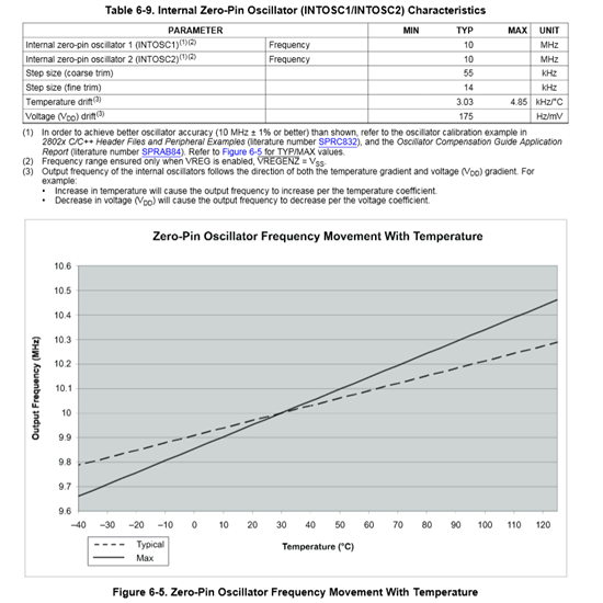

Can you provide me with the following information for the main oscillator of the C2000 LaunchPad board?
(1) Is it a RC oscillator or a crystal oscillator?
(2) Is it internal or external to the microcontroller?
(3) If external then is it part of the high-end-timer unit or a separate crystal?
(4) What Is the stability and accuracy of the oscillator?
(5) If the main oscillator does not meet my needs with respect to stability and accuracy can an external oscillator be easily connected to the Hercules board?
    There's no external crystal on launchpad.
    On launchpad they use the On-chip crystal-oscillator.
    Nope, its internal
    Refer: 0876.oscillator.pdf
    For more info: you can refer the datasheet of TMS320F28027

  • Can anybody help me find the Stability and accuracy information for the C2000 LaunchPad board?
  • Hi Dan,
    See the F2802x device datasheet.  You can get 1% accuracy with active temperature compensation, or something around 4.5% accuracy without compensation.
