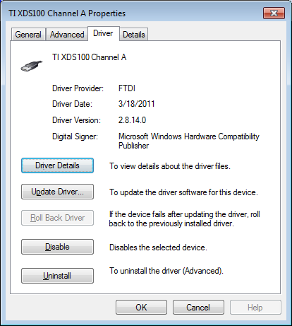

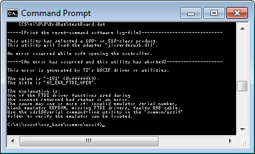

  • Both cables give same error on TMDSHVMTRINSPIN.  Both cables are successful on Experimenter's Board.
    The test error from CCSv6 is:
    The test was also performed through DOS-command line:
    And yields the same result on both cables.  Both cables were successful on the Experimenter's Board, the CCSv6 GUI yields the same results as the command.com:
    The bitmaps are a little fuzzy, but you get the idea. The FTDI driver was also upgraded to the latest version:
    The TMDSHVMTRINSPIN interface is still not functioning.
