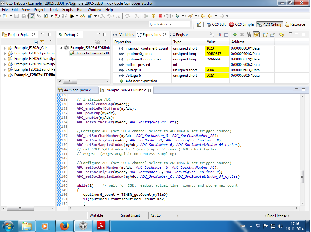

adc_isr not serviced on LaunchPadXL
Other Parts Discussed in Thread: CONTROLSUITE
I'm using a C2000 LaunchPadXL withF28027 and the following code, which light up the leds 1&3 or 2&4 (GPIO 0/1/2/3), depending on the state of the onboard button (GPIO12). It also shows the CLK/4 at GPIO 18. This works fine, however why is the ISR not serviced in this case? What do I wrong?
// COMMENTS CLK/ADC/GPIO example
// example program with debug expressions
// button_pressed, loop_counter, isr_counter, Voltage_6
#include "DSP28x_Project.h"     // Device Headerfile and Examples Include File
#include "f2802x_common/include/clk.h"
#include "f2802x_common/include/gpio.h"
#include "f2802x_common/include/pll.h"
#include "f2802x_common/include/wdog.h"
#include "f2802x_common/include/adc.h"
#include "f2802x_common/include/pie.h"
int button_pressed = 0;
long int loop_counter = 0;
long int isr_counter = 0;
uint_least16_t Voltage_6;
CLK_Handle myClk;
GPIO_Handle myGpio;
WDOG_Handle myWDog;
PLL_Handle myPll;
ADC_Handle myADC;
void main(void)
    // Initialize all the handles needed for this application
    myClk = CLK_init((void *)CLK_BASE_ADDR, sizeof(CLK_Obj));
    myGpio = GPIO_init((void *)GPIO_BASE_ADDR, sizeof(GPIO_Obj));
    myPll = PLL_init((void *)PLL_BASE_ADDR, sizeof(PLL_Obj));
    myWDog = WDOG_init((void *)WDOG_BASE_ADDR, sizeof(WDOG_Obj));
    myADC = ADC_init((void *)ADC_BASE_ADDR, sizeof(ADC_Obj));
    // Perform basic system initialization
    WDOG_disable(myWDog);
    //Select the internal oscillator 1 as the clock source
    CLK_setOscSrc(myClk, CLK_OscSrc_Internal);
    CLK_enableAdcClock(myClk);
    // Setup the PLL for x10 /2 which will yield 10MHz * 12 / 2 = 60MHz
    PLL_setup(myPll, PLL_Multiplier_12, PLL_DivideSelect_ClkIn_by_2);
    // Initalize GPIO
    GPIO_setDirection(myGpio, GPIO_Number_18, GPIO_Direction_Output);
    GPIO_setMode(myGpio, GPIO_Number_18, GPIO_18_Mode_XCLKOUT);  // SYSCLKOUT/4 op GPIO-18
    GPIO_setPullUp(myGpio, GPIO_Number_12, GPIO_PullUp_Disable);
    GPIO_setMode(myGpio, GPIO_Number_12, GPIO_12_Mode_GeneralPurpose);  // onboard push button
    GPIO_setDirection(myGpio, GPIO_Number_12, GPIO_Direction_Input);
    GPIO_setPullUp(myGpio, GPIO_Number_0, GPIO_PullUp_Enable);			// pull-up 20k on board led 1
    GPIO_setMode(myGpio, GPIO_Number_0, GPIO_0_Mode_GeneralPurpose);
    GPIO_setDirection(myGpio, GPIO_Number_0, GPIO_Direction_Output);
    GPIO_setPullUp(myGpio, GPIO_Number_1, GPIO_PullUp_Enable);
    GPIO_setMode(myGpio, GPIO_Number_1, GPIO_0_Mode_GeneralPurpose);
    GPIO_setDirection(myGpio, GPIO_Number_1, GPIO_Direction_Output);
    GPIO_setPullUp(myGpio, GPIO_Number_2, GPIO_PullUp_Enable);
    GPIO_setMode(myGpio, GPIO_Number_2, GPIO_0_Mode_GeneralPurpose);
    GPIO_setDirection(myGpio, GPIO_Number_2, GPIO_Direction_Output);
    GPIO_setPullUp(myGpio, GPIO_Number_3, GPIO_PullUp_Enable);
    GPIO_setMode(myGpio, GPIO_Number_3, GPIO_0_Mode_GeneralPurpose);
    GPIO_setDirection(myGpio, GPIO_Number_3, GPIO_Direction_Output);
    // Initalize ADC
    ADC_enableBandGap(myADC);
    ADC_enableRefBuffers(myADC);
    ADC_powerUp(myADC);
    ADC_enable(myADC);
    ADC_setVoltRefSrc(myADC, ADC_VoltageRefSrc_Int);
    ADC_enableInt(myADC, ADC_IntNumber_6);
    ADC_setIntMode(myADC, ADC_IntNumber_6, ADC_IntMode_ClearFlag);   // EOC (End Of Conversion) or ClearFlag
  while(1)		// loop and wait for interrupt
	if(GPIO_getData(myGpio, GPIO_Number_12) != 1) // board button GPIO_12 not pressed
    	GPIO_setHigh(myGpio, GPIO_Number_0); // led off (not pressed)
    	GPIO_setLow(myGpio, GPIO_Number_1);
    	GPIO_setHigh(myGpio, GPIO_Number_2);
    	GPIO_setLow(myGpio, GPIO_Number_3);
    	button_pressed = 0;
    else
    	GPIO_setLow(myGpio, GPIO_Number_0); // led on (pressed)
    	GPIO_setHigh(myGpio, GPIO_Number_1);
    	GPIO_setLow(myGpio, GPIO_Number_2);
    	GPIO_setHigh(myGpio, GPIO_Number_3);
    	button_pressed = 1;
	loop_counter++;
interrupt void adc_isr(void)
	isr_counter++;
	Voltage_6 = ADC_readResult(myADC, ADC_ResultNumber_6);
	ADC_clearIntFlag(myADC, ADC_IntNumber_6); // Clear ADCINT6 flag reinitialize for next SOC (start of conversion)
	return;
// No more.
  • Hi Bart,
    I checked your code, you've not at all enbled the ADC interrupt in your code. ie configure the PIE register.
    Please refer this code and configure accordingly:

    __interrupt void adc_isr(void)
        //discard ADCRESULT0 as part of the workaround to the 1st sample errata for rev0
        Voltage1[ConversionCount] = ADC_readResult(myAdc, ADC_ResultNumber_1);
        Voltage2[ConversionCount] = ADC_readResult(myAdc, ADC_ResultNumber_2);
        // If 10 conversions have been logged, start over
        if(ConversionCount == 9)
            ConversionCount = 0;
        else ConversionCount++;
        // Clear ADCINT1 flag reinitialize for next SOC
        ADC_clearIntFlag(myAdc, ADC_IntNumber_1);
        // Acknowledge interrupt to PIE
        PIE_clearInt(myPie, PIE_GroupNumber_10);
        return;
    Gautam

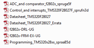

  • Hi Gautam, thank you for your reply.
    So the ADC_enable(myADC) and  the aditional ADC commands to set it properly is not enough... Do I always need the PIE_Handle for interrupts? Is that the only Handle to get my simple code working? Or do I also need the CPU_Handle? Where can I find the coherence between all these functionalities, and the datasheet of the f2802x?
    I have found the following documents, if you have some (better) additional ones please let me know... A lot of things are still unclear to me.
    There is also a big difference in syntax (and programming) shown in SPRAA85D.pdf and f2802x-FRM-EX-UG.pdf. What do you prefer to start with? Why are these differences created by TI?
    Bart

  • Hi Gautam, thanks again for your help. I appreciate it.
    The ADC on channel A0 and A6 is working now. I've coupled the ADC as mentioned in my previous post to the CPU timer0 interrupt, which occurs each second. I'm now investigating the conversion in more detail.
    Great! Do update us if you face any more issues on a separate post & please close the thread.
