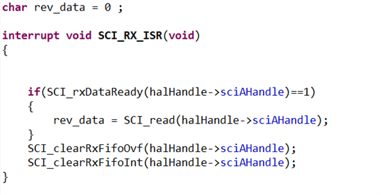

2) I add SCI receive interttupt function in proj_lab13e.c , and when I send a character to MCU , The CCS will report errors .

     2.I modifed my code , and the CCS compiler  shows normal , but  the program can not step into sci receive interrupt  fuction, I will check my code again.
    there are several posts on the front page about SCI and SPI communication. Note that most of these peripherals are NOT set-up / enabled in the example projects. We only set-up what is required for that specific example.
    You need to follow the examples of peripherals that are enabled and the HAL tutorial
