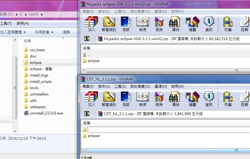

How can i see simplified chinese text correct?
thanks.
Guo Shin Chu said:How can i see simplified chinese text correct?
Read this article: http://processors.wiki.ti.com/index.php/Language_Pack_Installation
Gautam
Guo Shin Chu said:I can't find new software to update, please tell me where is wrong?
Yup, the sites seem to be taken down. Don't know why! Did you try by downloading the language packs meant for CCSv4? They're the compressed files available for download.
Gautam
The updates sites have been archived. The archive site is here:
http://archive.eclipse.org/technology/babel/index.php
Grab the one for your v5 release. CCSv5.0-5.2 is Indigo and 5.3-5.5 is Juno.
