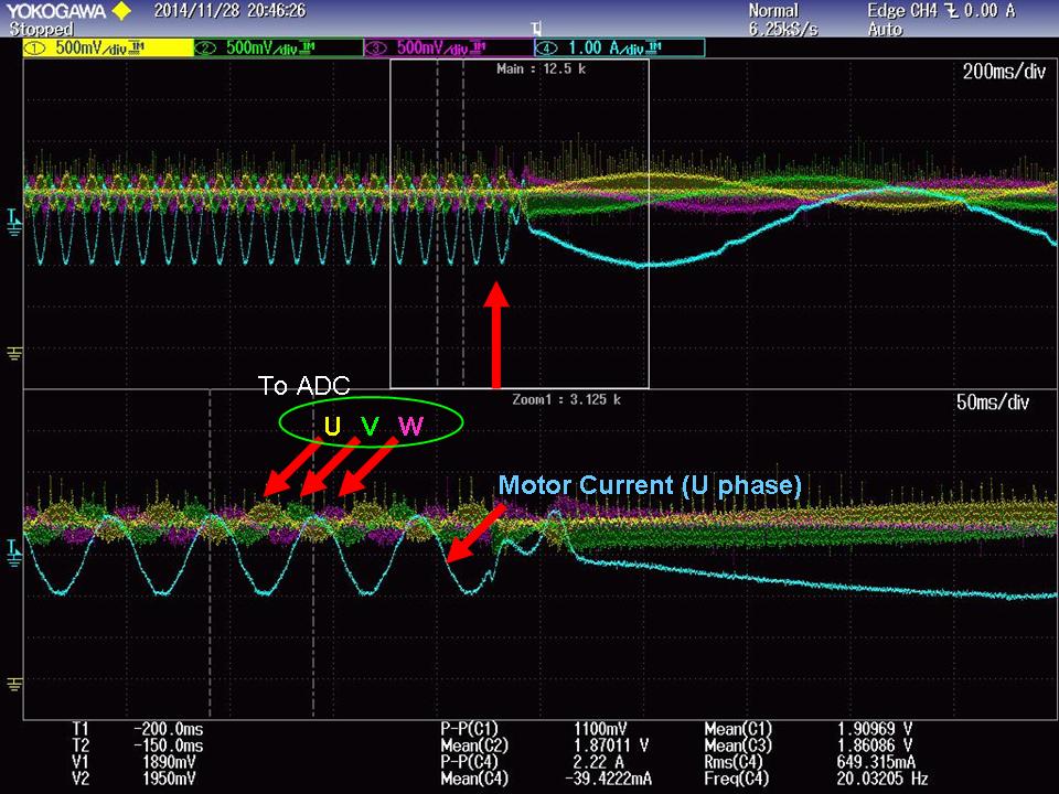

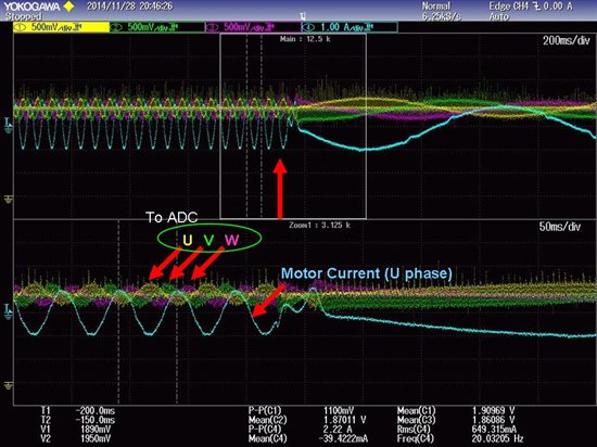

    Current operating order
    1: motor vibrates. 314Hz
    2: 0.7A about direct current flows.
    3: motor is rotating at 20Hz. (Dirty triangle wave current)
    4: it becomes 1Hz, current is disturbed severely.
    Until 1.2 No. KIT and movement are the same.
    3 or later is is strange.
    No. 3 should sine wave comes out, but it is close to a triangular wave. (Observed in the motor current .U phase)
    In the fourth phase, the current is reduced by a sine wave, then should flowing maximum current. However, it is a movement, such as the motor is to step-out and vibration.

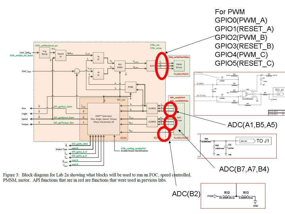

    HAL_setupAdcs () to have been defined as follows
    A1: I-U
    B5: I-V
    A5: I-W
    A2: I-Total (Only connect / Not define)
    B7: V-U
    A7: V-V
    B4: V-W
    B2: V-DCBUS
    (A3,B1 is not connect in my board)
    For my universal board noise is large, the voltage and current detection unit, you have to insert the LPF (1kΩ, 0.1uF) in front of the ADC input.
    It may be have failed to identify a problem of the time constant.

  • I just read back through the post and realized that you have CUSTOM hardware.
    Obviously something is wrong with your custom HW circuit.  It's hard to say exactly what, but you need to start with your current and voltage sensing...and make sure that your pin assignments in your hal files matches up with your HW.
  • Thank you for your help.
    After replacing the DRV8312 has changed a little situation.
    The identified yet I will fail.
    Should the current is reduced during of identification, has changed the frequency.
    For this waveform, What do you think?
    KIT The current and voltage bias is different, it was confirmed that it has been entered correctly F28069M.
    Pin assignment of the ADC of HAL file is also correct.
    Basically, I think that there is no need to change I have been together KIT and pin assignments.
    I have question.
    C:\TI\guicomposer\webapps\InstaSPIN_FOC_F2806xM\InstaSPIN_FOC_F2806xM.exe
    Since the pin assignment is the same, so I want to try using this. However, identification target hardware does not become DRV8312. Where can I Will have to determine the type of kit in the software?
    Also, is it possible I want to build the same as the appProgram from the source?
  • the GUI you are trying to use is "frozen", meaning we don't give you the source and let you recompile.
    if you want to have a GUI to instrument a MotorWare based project for one of the kits or your own hardware please use INSTASPINUNIVERSALGUI
    I can't debug from your scope shot. I would still look at your voltages/currents.

    <Regarding to Lab02a>
    1. Using this software, the pin assignment of the MPU needed to complete the identification, are understood to be those described below.
    Is my understanding correct?
    GPIO0(PWM_A)
    GPIO1(RESET_A)
    GPIO2(PWM_B)
    GPIO3(RESET_B)
    GPIO4(PWM_C)
    GPIO5(RESET_C)
    ADC-A1(IA-FB)
    ADC-B5(IB-FB)
    ADC-A5(IC-FB)
    ADC-B7(ADC-Vhb1)
    ADC-A7(ADC-Vhb2)
    ADC-B4(ADC-Vhb3)
    ADC-B2( VDCBUS)
    If any other pin is not connected that is fine to working the software. I was understand.
    Is there a pull-up/down is necessary pin?
    2. Input of the noise of the AD conversion (voltage ripple)
    How likely are you affect the identification?
    DRV8312EVM_RevD was about 80mV.
    My board was about 140mV.
    <Regarding hardware target type at GUI>
    Please let me know,how do appProgram determine type of hardware?
    Is it the pin assignment?
    or Is it ID in ram/rom?
    I want to to know is the discrimination of the target.
    Thank you very much your help!!
  • 1. all peripherals used are set-up in the HAL.C file for the specific board + MCU combination, ex:
    C:\ti\motorware\motorware_1_01_00_13\sw\modules\hal\boards\drv8312kit_revD\f28x\f2806x\src
    2. I can't give you a min/max value, that's not something we specify
    3. The source for the "frozen" GUI looks at differences in some key GPIO to determine if the hardware is the DRV8301 EVM, DRV8312 EVM, or HVMTR EVM. Let me re-iterate - you can NOT use this frozen binary on your own HW. I guarantee it will not work. Create your own binary using MotorWare.
  • Hi Chris.
    Thank you for your reply!!
    I am grateful for your great help.
    My intention does not seem conveys to you well.
    I will use a combination of Pro2a and DRV8312EVA_REVD.
    At that time, for the identification of the motor, minimum required signals required becomes 13 pins. So I will not understand.
    And is input to the ADC of the MPU, captured data are converted to a physical quantity required, and then changes the PWM duty of to control the motor.
    For example, current
    It is determined by the hardware of value(R54,R30,R16,R35,R26,VCC)
    USER_ADC_FULL_SCALE_CURRENT_A
    And, it is determined 1.2 to 1.3 times the value of the peak current DRV8312
    USER_IQ_FULL_SCALE_CURRENT_A
    , The data of the captured ADC is converted into a current, to determine the duty of the PWM.
    Some settings such as the CPU clock, but in the purpose of the identification of the motor, the minimum required thing as a peripheral module will ADC and PWM.
    In addition, in order to convert the data captured by the ADC, if defined, such as USER_ADC_FULL_SCALE_CURRENT_A is long as be set correctly, the goal should be achieved.
    I understand as this.
    These understanding correct?, I want to make sure.
    OK.
    >3.in some key GPIO to determine
    I'm not looking for a guarantee.
    You if possible, I wanted to know whether is set how GPIO of KEY is.:) Thank you!!
