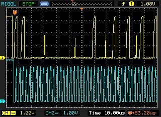

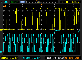

       I am trying interface eeprom 24c02 IC using I2C with F28069.I want to write multiple Write byte constructively and want to read random address read and Multiple read byte opearation.
  I am using sample code of I2C_eeprom of F28069 for write 2 byte on 0x0001 and 0x0002 memory add. location and also read same location. after read I get same data which is i write on 0x0002.
Please find attached waveform which I captured foe 2 byte write operation.
From which I knew only first data has been written.
Please help me for write multiple write data.

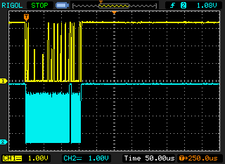

    I am doing the same way  operation write and read.I got the expected data.But If do the following way,
     WriteByte(addr1, data1);
    WriteByte(addr2, data2);
    addr1Content = ReadByte(addr1);
    addr2Content = ReadByte(addr2);
    addr1Content and addr2Content are same value i.e. data2
    after that  I ma doing only
    for testing purpose .I checked the wave forms on DSO. Please find attached files of wave forms.If you observed the waveform you will find that only first data was written.second is uncompleted.but  In s/w its look 2nd data was also written.
    Waiting for reply.

    If you put delay between writing process (for example 5ms), and then read them, what will be the result?

    	DELAY_US(5000);								// 5ms = write cycle time of 24LC256 - based on datasheet 24LC256
