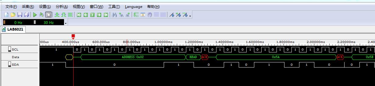

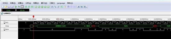

config MCU as I2C slave and it cannot send data
     my I2C project :
(1) when master(MCU) is writting data to slave , and slave can receive correct .
(2) but master is reading data from slave,and slave can not send correct  data.

interrupt void I2CIsr(void)     // I2C-A
	Uint16 IntSource = 0;
	// Read interrupt source
	IntSource = I2caRegs.I2CISRC.all;
	if(IntSource == I2C_AAS_ISRC)
	else
	if(IntSource == I2C_TX_ISRC)
		I2caRegs.I2CDXR = 10;
	else if(IntSource == I2C_RX_ISRC)
		CommSlave.Buffer[CommSlave.Unit.bit.RecvNum].bit.RecvBuf = I2caRegs.I2CDRR;
		if(CommSlave.Unit.bit.RecvNum < sizeof(CommSlave.Buffer))
			CommSlave.Unit.bit.RecvNum++;
		CommSlave.Unit.bit.RecvFlag = 1;
		CommSlave.Unit.bit.RecvCompleteTime = 0;
	PieCtrlRegs.PIEACK.all = PIEACK_GROUP8;
thanks!
