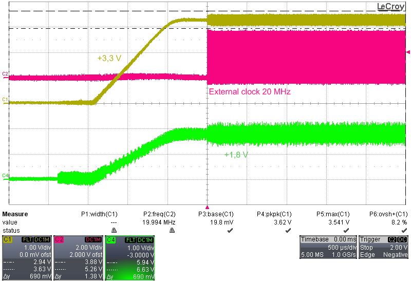

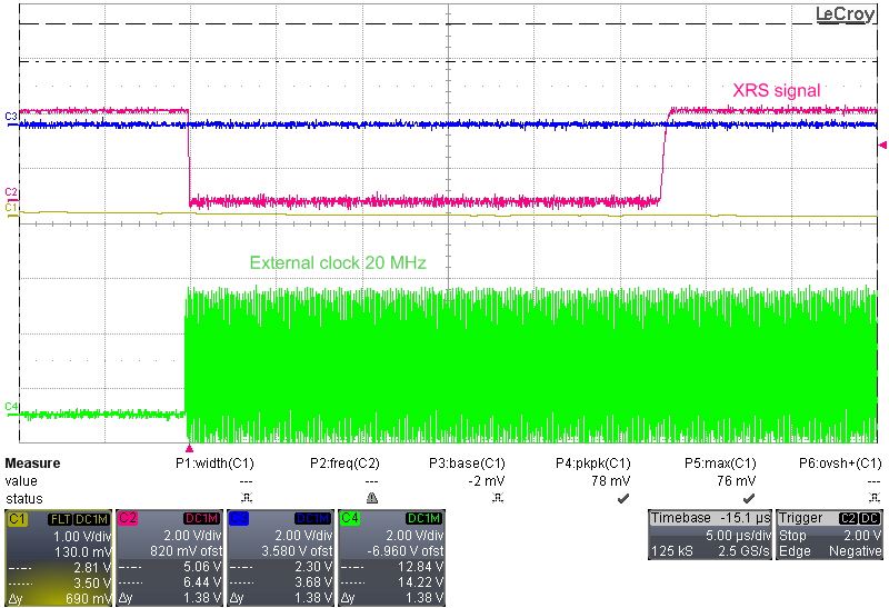

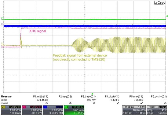

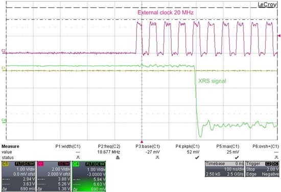

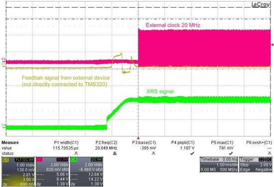

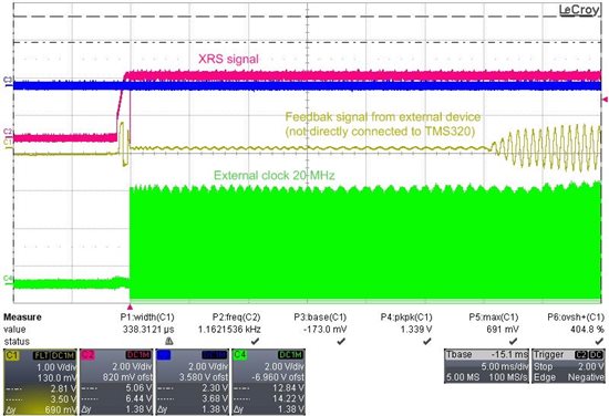

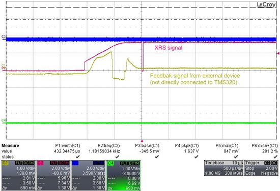

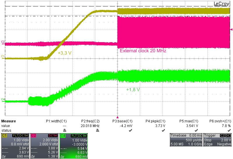

I have few circuit boards with TMS320F28335 on it. Some of them work correctly, as expected (figure 1), but couple set  XRS pin to low level after power up for a short-term (figure 2-4). It seems like watchdog reset, but only 4-5 clock pulses preceded to this (figure 5) and watchdog was disabled by software (program runs from FLASH, it is same for all boards). I tried to compare supply voltages on different boards and it looks identical on boards with reset on start (figure 6) and without it (figure 7).

Figure 1
Figure 2
Figure 3
Figure 4
Figure 5
Figure 6
