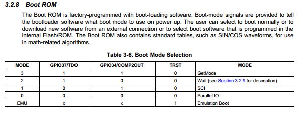

          can I use the kit TMDSPLCKIT-v3 (born for PLC) with the IDE Energy? I try to follow this guide http://energia.nu/pin-maps/guide_c2000launchpad/ . It's for launchpad but micro is the same. ù
But, when I try to upload a blink sketch, appear a prompt that tells me to change the boot switch to "up", "down", "down". Which switches should I change on this card?
    Yes, Energia has been implemented for C2000 launchpads mcus ie F28027 and F28027F.
    These are the boot switches ie boot GPIOs that you can get info in the datasheet.
    Gautam
  • Where do you find the image that you post? I can't find these gpio on this KIT
    I would like use it with Energia for PLC.
