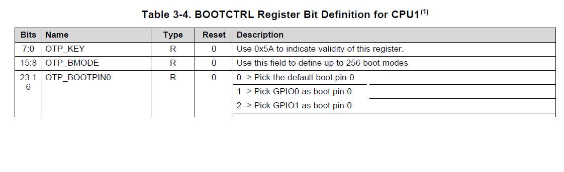

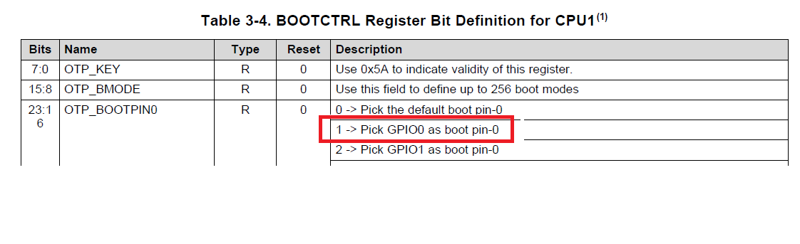

    Here is quick thing to check -
    Please note that the decoding of the pin number. What mentioned in the TRM is decimal value and what you program in BOOTCTRL location is in hex. So you need to convert the value written into register to decimal for pin number. E.g. in this case you have written 0x56580B5A which means you are choosing GPIO pin number 85 (0x56 -1) and 87 (0x58 -1). If you expecting it to be 55/56 (or 56/57, in case you didn't notice that value "1" select GPIO-0 pin not GPIO-1) then that will be an issue.
    Following is what we have in TRM -
    Please check the same. I hope this resolve the issue. If not then as Santosh mention, use the boot ROM source code from controlSUITE to debug it further.
