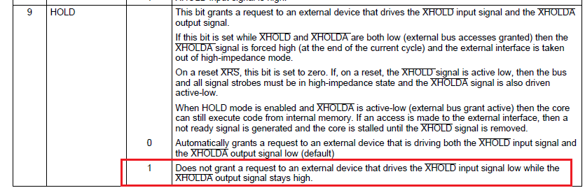

TMS320F28335 TZ3 and XHOLD signal multiplexing Problem.
Hi everyone,
I'm trying ti use EPWM TZ3 event with XINF enabled. I have external QUART attached with zone0. TZ3 is also multiplexed with XINF XHOLD input signal. when TZ event occurs, its halt zone0 interface. can anybody help me how to disable XHOLD signal of XINF.
