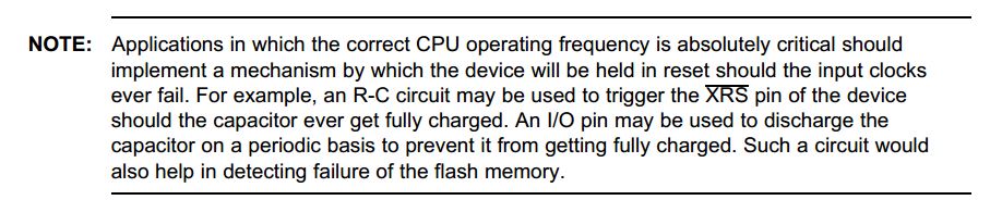

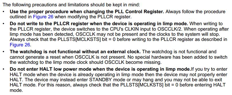

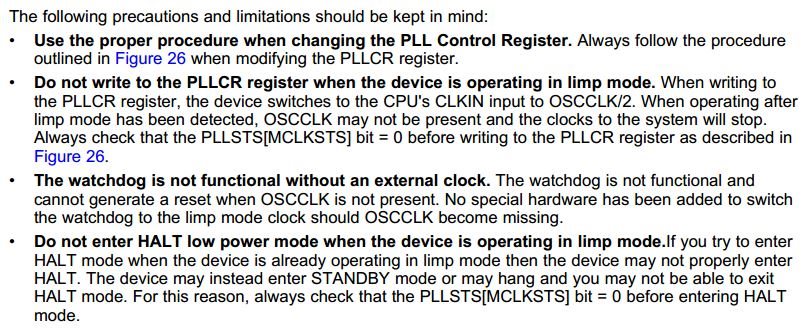

 Some of the other questions was:
1. Does the chip cease to function when PLL configurations are not right? as there was no change in the build but started getting this error.
What other reasons could be to cause this error.
