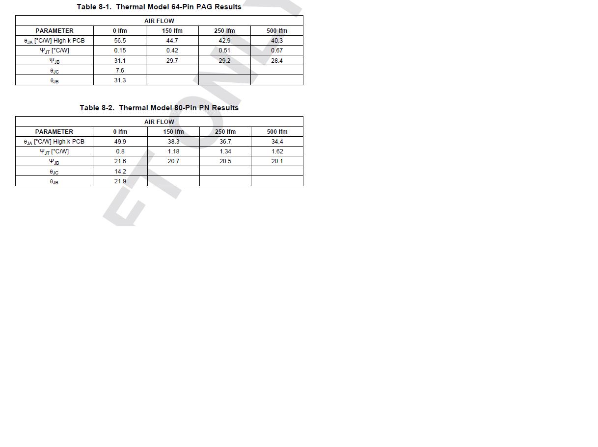

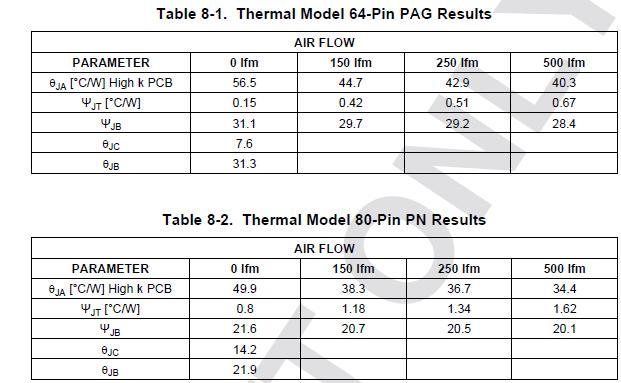

  • You'll need two things; below table showing thermal coeffs for the 28035 and this document to translate case temperatures to the junction temp measured by the temp sensor:
    http://focus.ti.com/lit/an/spra953a/spra953a.pdf
