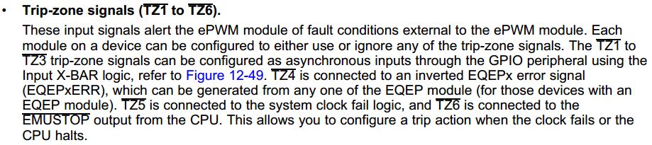

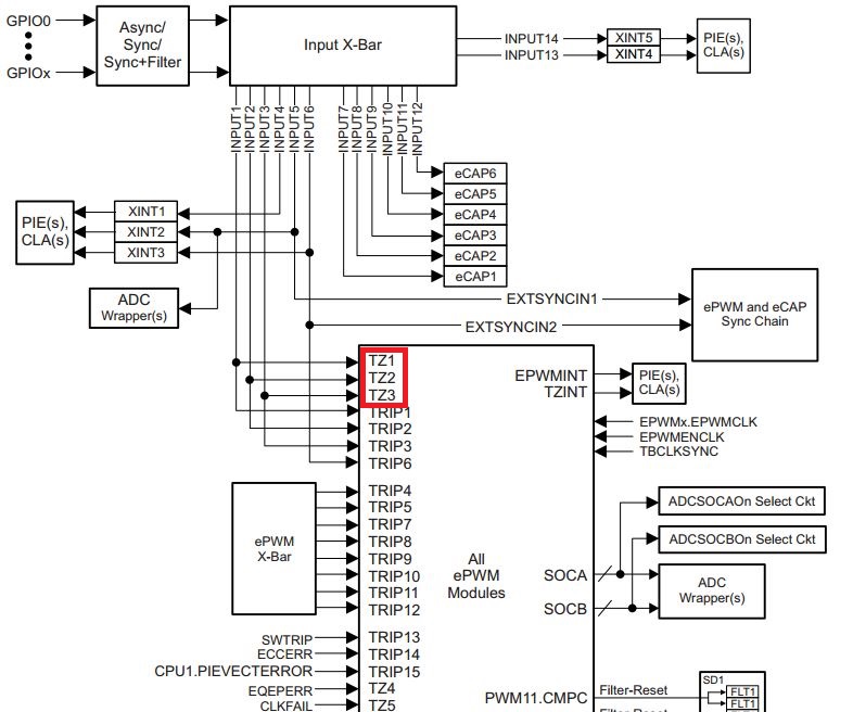

Sir,
What is the Use of Tz Pin in 28075,28075?
How to Access The TZ Pin as No Hardware Pins are mentioned in the datasheet.
