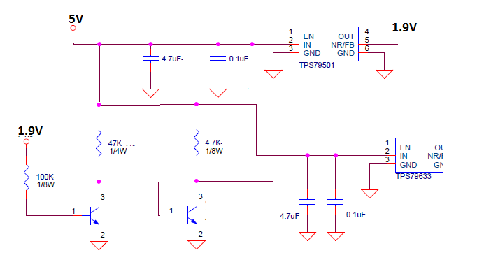

TMS320F28335 Example Circuit: Power Sequencing 3.3V and 1.9V
Guru 20045 points
Other Parts Discussed in Thread: TMS320F28335, CONTROLSUITEAre there any example circuits that show how to power sequence 3.3V and 1.9V correctly so the requirements of section 6.8 of the TMS320F28335 datasheet are met? The circuit I am currently working with uses separate regulator for 3.3V (TPS79633) and 1.9V (TPS79501). Both are tied to 5V and the enable of the 1.9V regulator is tied to 5V. The 1.9V regulator is connected to the base of a BJT transistor through a 100K ohm resistor. The collector of that transistor is connected both to 5V through a 47K Ohm resistor and to the base of another BJT. The Collector of the second BJT is both tied to 5V through a 4.7K Ohm resistor and the enable of the 3.3V regulator. The emitters of both BJTs are tied to Ground. For the circuit just described, the 3.3V regulator output starts ramping up at the time 5V reaches 1.8V and continues ramping up at the same rate as 5V until the 1.9V regulator output turns on (when 5V input is approximately 2.3V). At that time, the 3.3V output quickly shoots up to 2.5V and then ramps up to 3.3V at the same rate as 5V. Is there any way to make this circuit work? Stephen

  • Ok. After calling TI, I solved the forum posting issue. For some reason, my E2E Profile E2E Options Content Editor setting was set to text instead of enhanced.

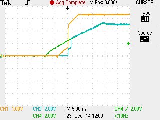

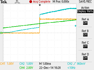

    The Power sequencing circuit is shown below.  Does anyone see any issues with it?  The Oscilloscope screenshot is shown below it.
     Green = 5V, Blue=3.3V and Orange = 1.9V.
     Green = 5V, Orange=3.3V and Blue = 3.3V Regulator Enable.

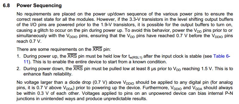

  • Seems fine but I would like you to refer this extract from the device datasheet: esp. the 3.3V & 1.9V part
    Gautam
  • Yes, specifically the last two sentences of the first paragraph:
    "However, if the 3.3-V transistors in the level shifting output buffers of the I/O pins are powered prior to the 1.9-V transistors, it is possible for the output buffers to turn on, causing a glitch to occur on the pin during power up. To avoid this behavior, power the VDD pins prior to or simultaneously with the VDDIO pins, ensuring that the VDD pins have reached 0.7 V before the VDDIO pins reach 0.7 V."
  • Exactly

  • Stephen,
    I am not too sure, but have some ideas on how to debug further (perhaps some you've already done):
    I'd personally start with (1) and then move forward.
    1) If this is a custom board, have you tried pulling off the LDOs, adding some flying leads, and powering the MCU & associated circuitry with external power supplies?  I have personally chased this type of issue several times now and often the power supplies aren't the problem.
    2) It may be worthwhile to add a small capacitor (maybe a few 10s of pF) on the EN of the TPS79633 LDO with the intent of potentially limiting switching noise on the EN line.  You could probably put it on top of your 4K7 resistor for now.  This capacitor may not change anything, but if you see any change in behavior you may now have somewhere to look.
    3) The ramp-y-ness of the TPS79633's EN pin near the region where it turns on may be another potential thing to look into.  Making your 4K7 pull-up resistor stronger, or changing the second switch from BJT to an appropriate MOSFET may improve things.

  • Hello Brett,
    What is the purpose of  #1 above.  I am not having any issues with my system. I am just wanting to make sure the 1.9V comes up first.
    Adding a 33pF capacitor across the 4.7kOhm resistor didn't change anything.
    Also, I have already changed the 2nd BJT to a mosfet (FDV301N) and that didn't change anything.
    Stephen

  • Hello Brett,
    That's correct - there are no issues with the system.
    As shown in  the first oscilloscope trace I posted, the 1.9V output  (orange trace) is 0V until 3.3V almost reaches 0.8V.  Therefore, I would say the 1.9V is not coincident with 3.3V since it doesn't come on at the same time as 3.3V.
    If 1.9V is somehow partially powering the 3.3V rail, wouldn't the 1.9V output show something greater than 0V?
    Stephen

    I think the crux of your issue lies with, "why is the 3.3V line ramping early?".
    I would recommend pulling off the TPS79633 and seeing if voltage still gets sourced onto the 3.3V line prior to the 1.9V line coming on (this will also allow you to see how the power sequencing circuit works on its own without a load).
    If the 3.3V still ramps, you know to look at other circuitry on the board.  This could be a number of things, but could also be the C2000 (if say one of its GPIO pins is pulled high before the chip is enabled).
    If it does not, then your intuition was right and the issue likely lies in the power sequencing circuit.  In this case, my guess is that 5V is going into the EN pin and starting to turn on the LDO before the 2nd FET turns on to pull EN to GND.  If this is the case, your best option may be to redesign to have EN come out of the emitter side of a FET which pulled to GND and controlled by 1.9V.  The other option is to find a FET with a "low enough" turn on voltage such that the EN line will be pulled low for a while prior to the 1.9V regulator turning on (and 3.3V always stays less than 0.7V during this time).
    Hopefully this helps.
    Thank you,
    Brett

    "If it does not, then your intuition was right and the issue likely lies in the power sequencing circuit.  In this case, my guess is that 5V is going into the EN pin and starting to turn on the LDO before the 2nd FET turns on to pull EN to GND.  If this is the case, your best option may be to redesign to have EN come out of the emitter side of a FET which pulled to GND and controlled by 1.9V.  The other option is to find a FET with a "low enough" turn on voltage such that the EN line will be pulled low for a while prior to the 1.9V regulator turning on (and 3.3V always stays less than 0.7V during this time)."
    According to the scope trace, shown in my previous post the 3.3V regulator enable is near zero volts when the 3.3V regulator output is ramping up, so I am suspecting the FETs not the problem.
