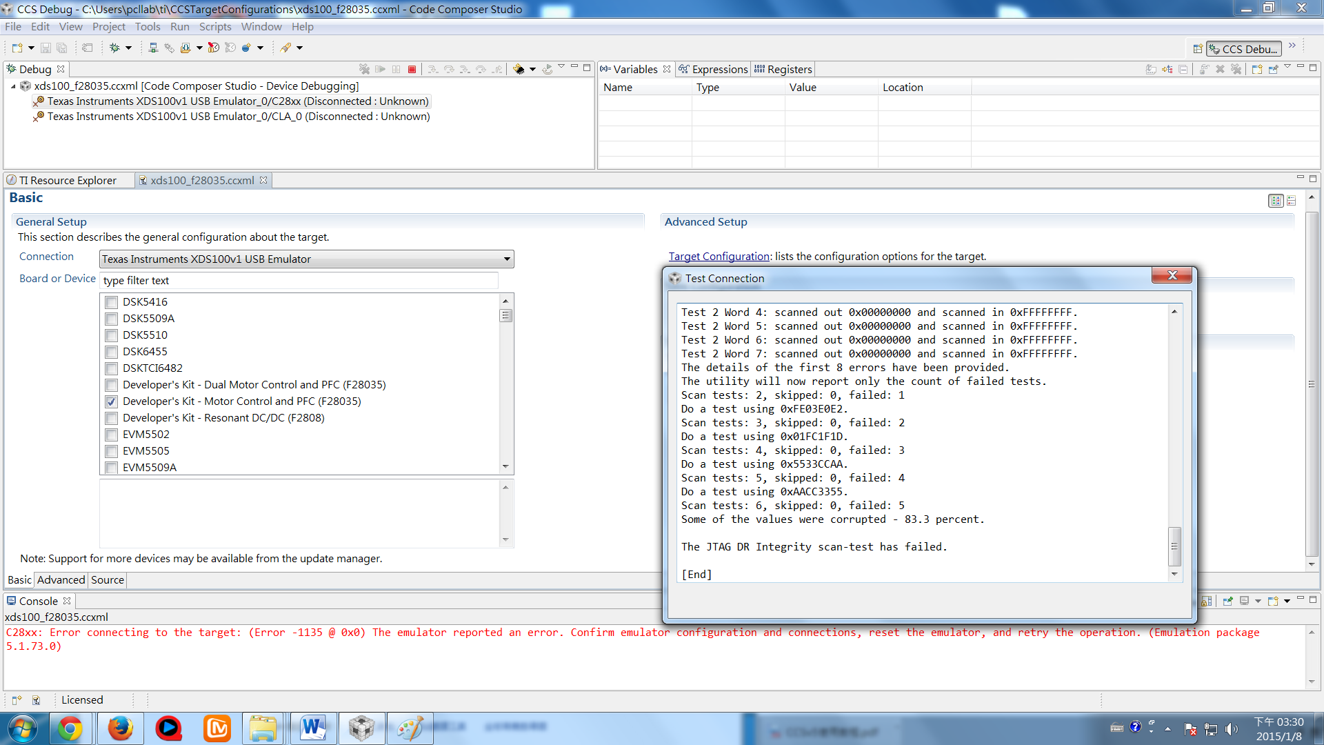

CCSv5.4 error connect to the target

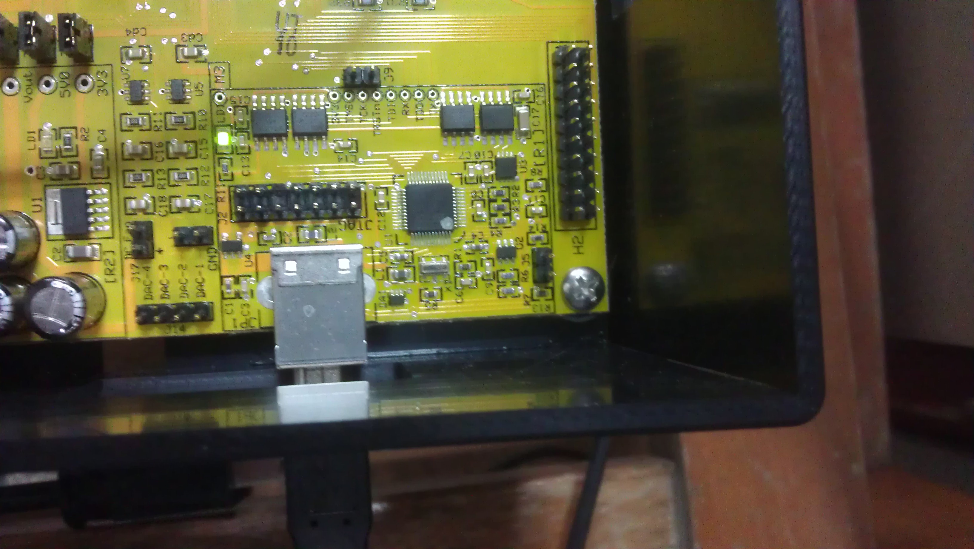

I bought the TMDSHVMTRPFCKIT and f28035 control card shipped this the kit.
Also i installed the CCS5.4v by the CD shipped  this the kit.
I can used the  "HVMTRPFCKIT-PM-ACI-GUI.exe" to control the the ACI motor.
But I got a problem when i wanted to use the CCS5.4 to connect the kit.
I choosed the xds100v1 USB Emulator and then clicked the "test connection"
I got the error below

I have read the Hardware Reference Guide and checked the F28035 SW1=off,SW3=off,SW2=on.
I would greatly appreciate any help you can give me.
