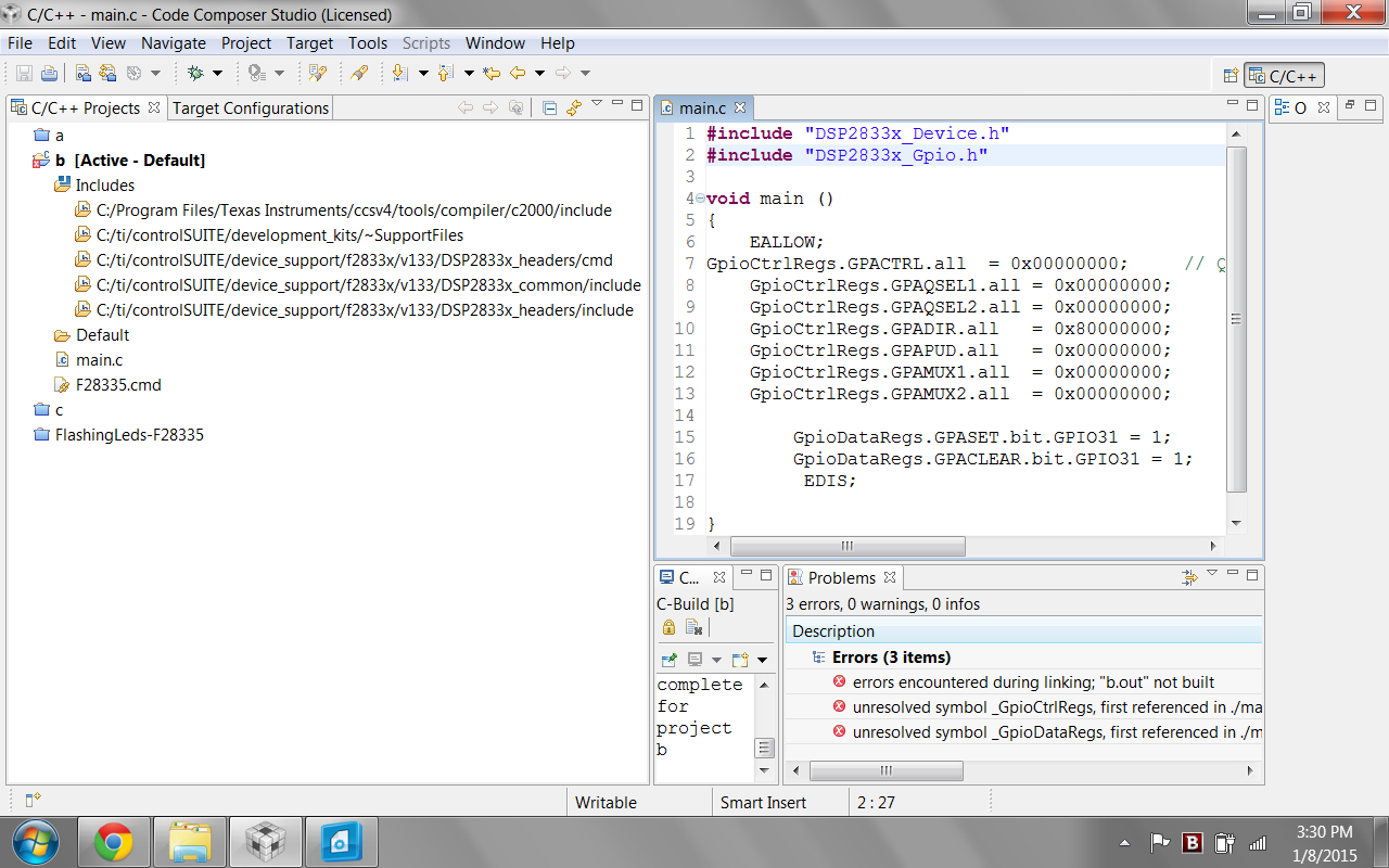

Error in f28335 custom code design
Other Parts Discussed in Thread: CONTROLSUITE
  • Hi Sai,
    Your project structure itself is faulty. Did you refer the sample project structure? You can import sample projects from here:
    C:\ti\controlSUITE\device_support\f2833x\v133\DSP2833x_examples_ccsv4
    Also, refer this workshop material for F28335 mcu:
