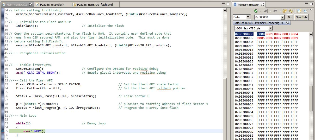

    I wrote you a very simple example that programs an small array into flash. It is attached. You can compare with your code.
    This is a fully self-contained CCS project, and leaves all the GPIO pins as inputs so you can run it on your board. It does expect a 30 MHz input clock (PLL x5, giving 150 MHz). If you do not have a 30 MHz clock on your board, you will need to modify the flash API file Flash2833x_API_Config.h to reflect your clock setup.
    The code programs the small array x[10] into flash sector H. Nothing else is linked to sector H, so it is free to use here (I can erase it, etc.). I did not know which version of CCS you have nor compiler version. I used a slightly older version of each so you could easily import the project. It is a CCS v5.5.0.00077 project using compiler v6.2.7. That CCS or later will import it just fine.
    Import the project into CCS, and build the project. Then, connect to your F28335 target and load the project (flash it). Set a breakpoint on the NOP in the main loop of main(). Open a memory window to address 0x30_0000 (start fo sector H). Right now, it should be all 0xFFFF (erased). Run to the breakpoint. You will see the x[] array 0,1,2,3,4,5,6,7,8,9 in sector H:
    After doing this, you can do Run->Restart, and set a breakpoint on the call to Flash_Program() line. Run to there. You'll see sector H is again erased. Hit Run again and hit the breakpoint in the main loop, and you'll see the x array again in sector H.
    You may not be able to set both breakpoints I described at the same time, depending on the options you have selected in your CCS setup.
    - David

  • Thanks David,
    Now it's working but the Flash_Erase takes about 100 seconds to be executed.
    Do you think that it is correct?
  • 100 sconds is too long. Should take maybe 5 - 10 seconds. For my example program (which I assume is what you are running), when I hit RUN it takes about 5 seconds to hit the breakpoint in the main loop. This is mostly for the erasure of sector H I assume.
    If you use CCS to erase sector H, how long does it take? (go to tools menu, then Flash Programmer, something like that).
    Have you tried more than one board?
    Is your board clock 30 MHz, as I said was needed for my example?
    - David
  • Now it is fast.
    I disabled the PLL for test.
    Thank so much for your support!
