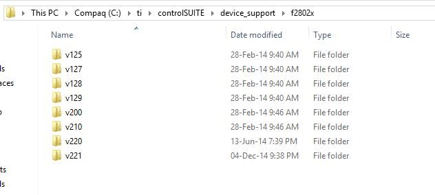

I see that controlSUITE has been updated (3.2.9) since my last install of it (3.2.8). Can someone tell me if the f2802x support files have been updated at the same time (I currently have v220). I thought it used to be possible to get these separately from controlSUITE if desired, but I can't seem to find a link for them now.
  • Hi Toby,
    F2802x folders are untouched in 3.2.9 version. Here are the subfolders:
    Gautam
  • Hi Gautam
    Thanks for the info. Looks like there is an addition of v221. Is it possible to download this by itself?

  • Toby,
    controlSUITE files are currently contained in a single package and can't be downloaded separately. But since you already have controlSUITE installed, you can run the controlSUITE updater to download just the files added in v3.2.9. Within the ~/controlSUITE root directory, run "controlSUITE.exe" (Recommended to be run as administrator on Windows) then select "Check for controlSUITE Updates" on the left side, and finally click the "Check for controlSUITE updates" on the page that appears on the right.  This should initiate an update to your controlSUITE.

  • You simply have to update controlSuite ("Run as Administrator" is important).

    Gautam
  • Thanks Gautam,, the "Run as Administrator" was key and something I never remember to think of!
