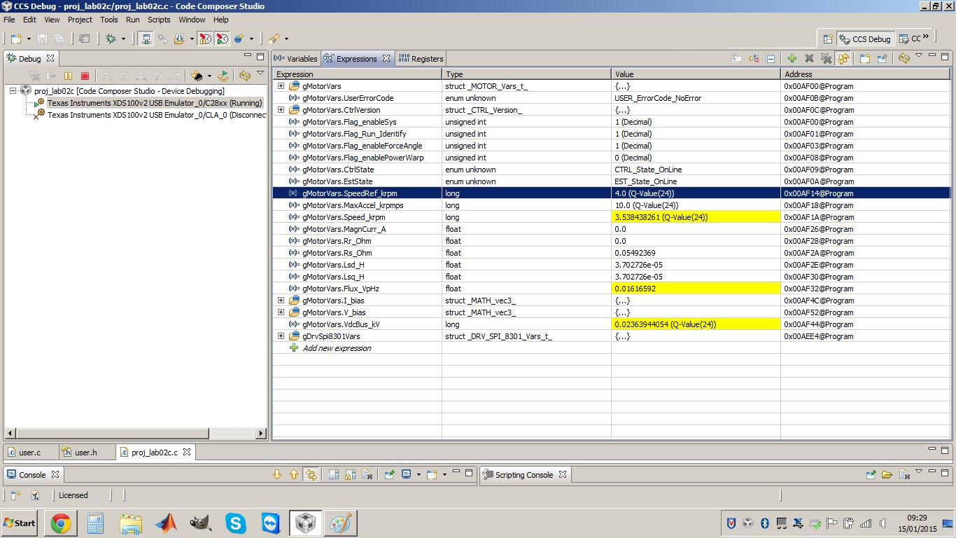

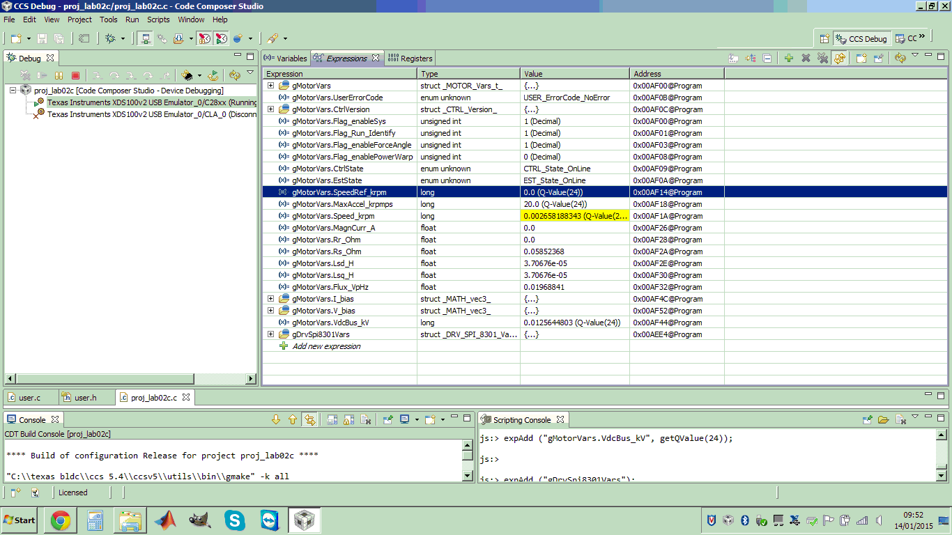

  • in your two images why are the gMotorVars.VdcBus_kv values different?  You should be running at the same bus voltage.

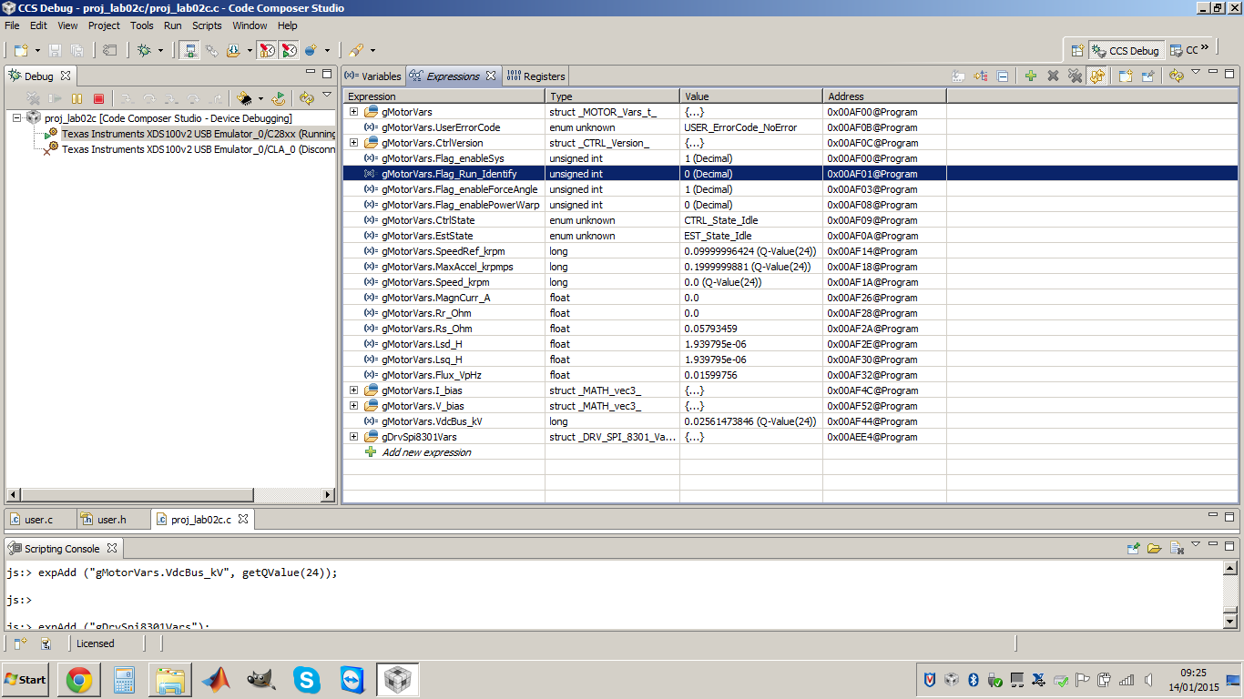

    here is the updated user file I arrived at the lab 5, but I can not reach speeds above 3.5 krpm this engine reaches 5k, and I have some jerky motion at low speed as I can solve them?

  • thanks for the file user modified the tried and I think I will use your engine runs better at low speed.
    if I put
    #define USER_IQ_FULL_SCALE_VOLTAGE_V (12.0)
    as you can see the values that I read on
    gMotorVars.VdcBus_kV 0.024967134 and twice as must be why I said to divide by 2
    USER_VOLTAGE_SF ((float_t) ((USER_ADC_FULL_SCALE_VOLTAGE_V) / (USER_IQ_FULL_SCALE_VOLTAGE_V)))
    my problem now is in the extremes of speed, particularly below 200 rpm stutters ie crashes and then makes a turn and so always.
    as you can see from the screenshot instead the engine does not exceed 3.5 krpm although it can get up to 5 krpm thing which parameter must be configured to solve this problem?
  • do NOT change the scale factor!! It affects more than your bus reading. I don't understand why your bus would be reading 24 if it's actually 12...that doesn't make sense.....but do NOT change the #define for the scale factor in user.h!

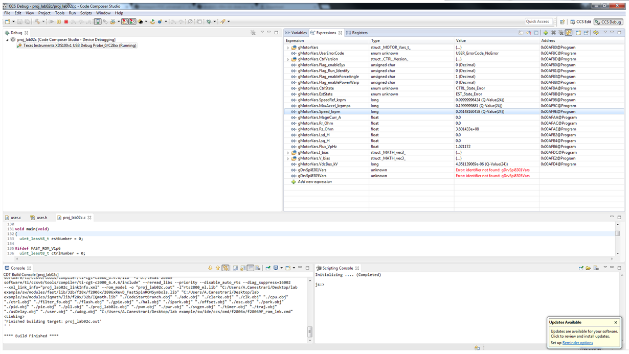

    i can compile, flash and execute but
    i can't run the motor, and i receive that error ind red (screenshot) and the parameter are complity wrong like vdc bus.
    what you suggest to do ?
    thanks
  • i don't think you imported and built the correct project for this board. recheck the path. it is board specific to drv8301evm_revd

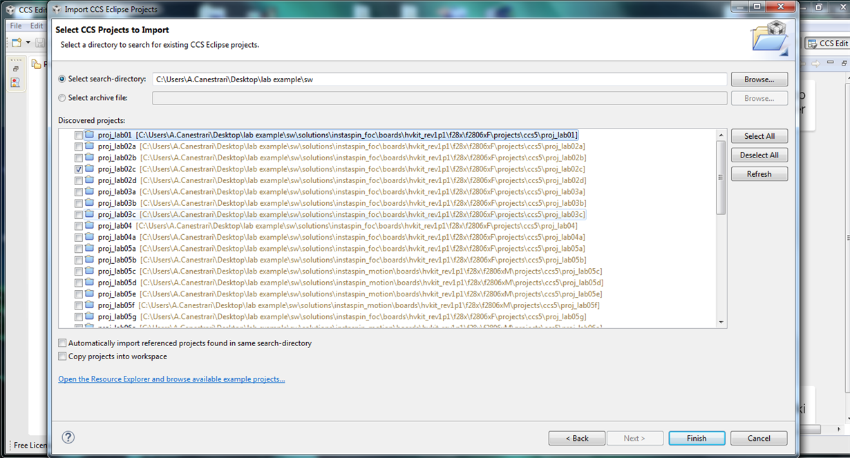

  • hello cris,
    I copied the folder sw located in motorware in lab example in order to have this as a backup and work in lab example.
    This is the project that flash with its path does not see anything strange, but you can tell me.
    regards
    H
  • look at your project path, it uses "hvkit_rev1p1"
    didn't you say you are using the DRV8301-69M-KIT?
    use the projects at
    C:\ti\motorware\motorware_1_01_00_15\sw\solutions\instaspin_foc\boards\drv8301kit_revD\f28x\f2806xF\projects\ccs5
