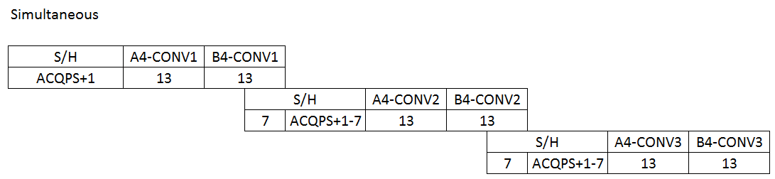

  • Hi René-
    For F28027 there are two S/H circuits which provide for parallel sampling, but only one converter so switching to simultaneous sampling only reduces the S/H time.  When using OVERLAP mode, the first 7 ADCCLK of S/H are already "free" since they overlap with the previous cycle's conversion, therefore there really is no throughput benefit to simultaneous+OVERLAP mode unless you use an increased sample window.  Hopefully this representation helps illustrate the point, the numbers in the boxes represent the number of ADCCLKs for each phase:
    Joe

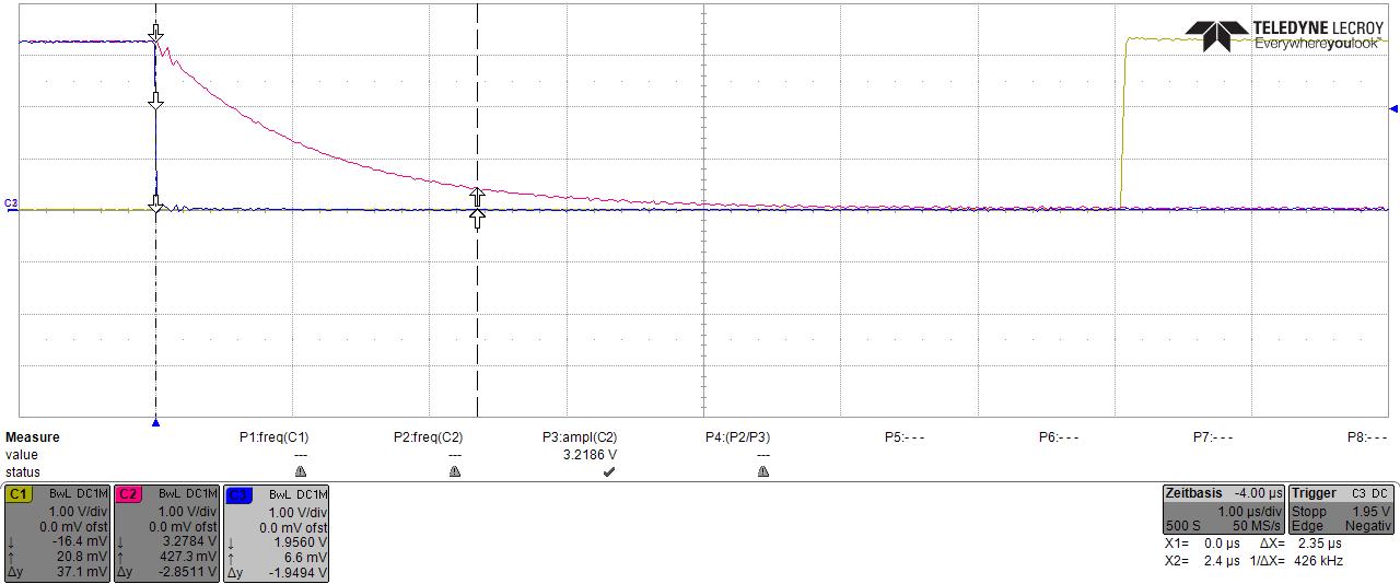

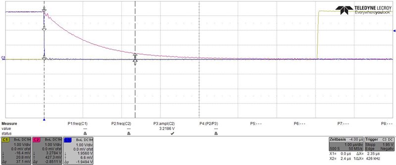

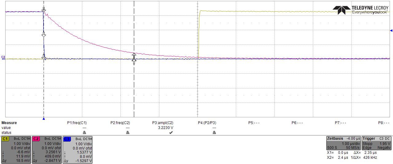

    Here are the signals
    Channel 1 (yellow): ADC Interrupt toggle GPIO1 at EOC. (AdcRegs.INTSEL1N2.bit.INT1SEL = 15; //setup EOC15 to trigger ADCINT1 to fire)
    Channel 2 (red); signal on ADC input
    Channel 3 (blue): PWM signal, falling edge SOC (EPwm1Regs.ETSEL.bit.SOCASEL = ET_CTRU_CMPA; // Select SOC from from CPMA on upcount)
    Sequential mode:
    Simultaneous mode:

    But this is exactly my problem. With my example code above the simultaneous mode is 7us long and the sequential 4us. So nearly twice as fast as simultaneous mode.

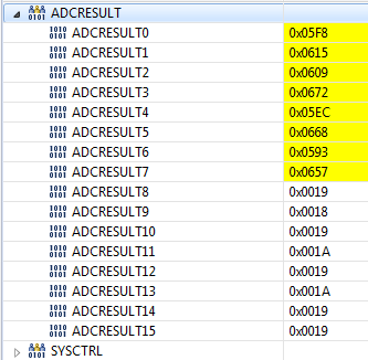

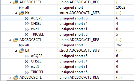

  • Hi Devin
    this was my first intention too but that doesn't work.
    If I change it I'll only get results from the first 8 channels.
    Here a printscreens of the AdcRegs and ADCRESULT with this config.
    Could you test my example above?
    René

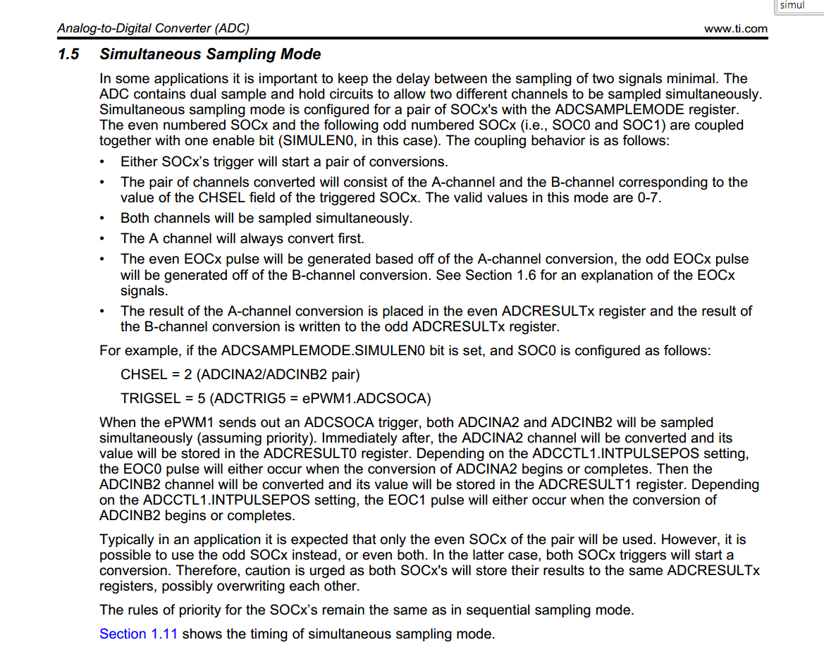

    SOC0 or SOC1 act as the same unit when using simultaneously sampling, so only one needs to be enabled.  The result from channel A goes into ADCRESULT0 and the result from channel B goes into ADCRESULT1.
