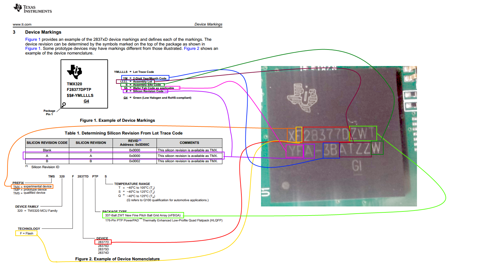

I have purchaced tow controlcard: f28m36 & f28377d
The cores, ie tms320f28377d and the tms320f28m36p63c2, which are on the board, are not same as the original one's form TI.
Can you know anything about this?
I upload the photos, I have taked.
thanks in advance.
