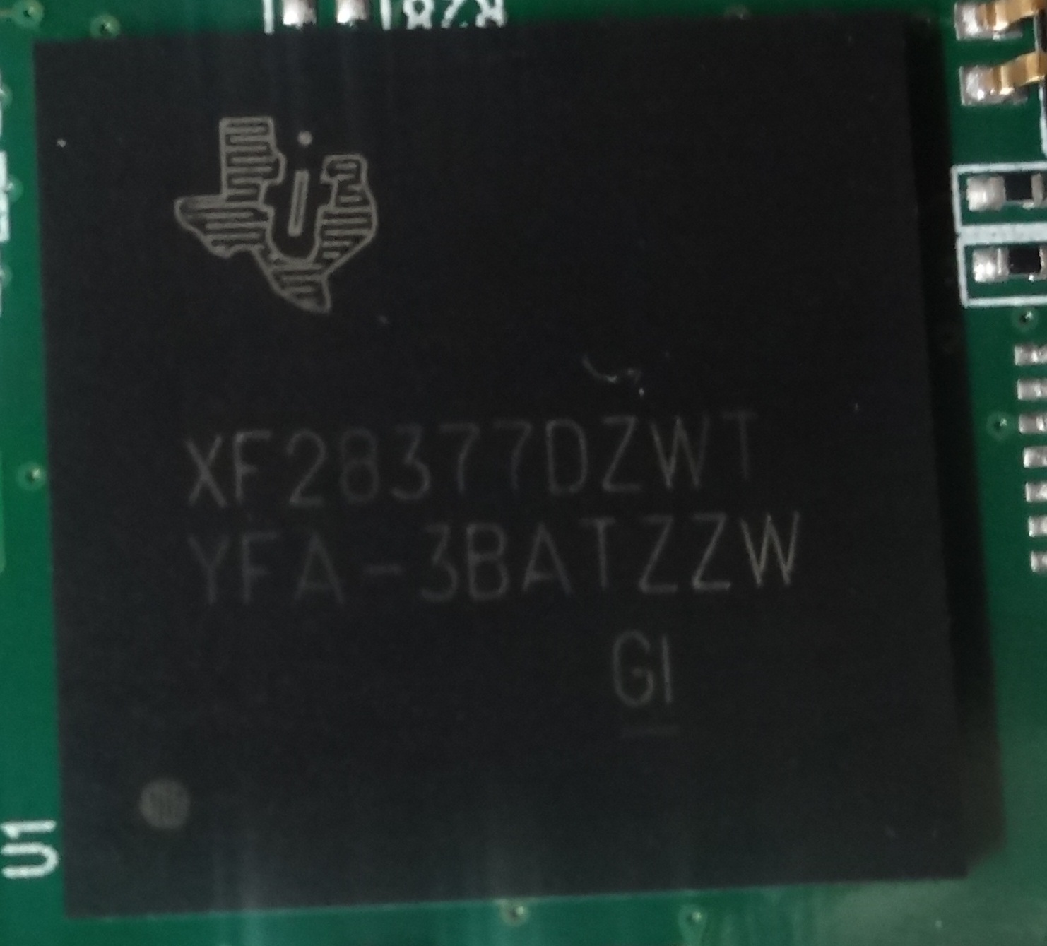

Dear All,
I have purchased tow control cards of 28m36 and 28377d from not authorized distributor!
The bellow pictures are the two mcus of them:
The boards work correctly.
Are the print on the ICs normal with your opinion?

When we built this version of the silicon we used a template for the symbol and this number signifies the TI logo. On the F2837x devices we have standardized the TI logo now.
