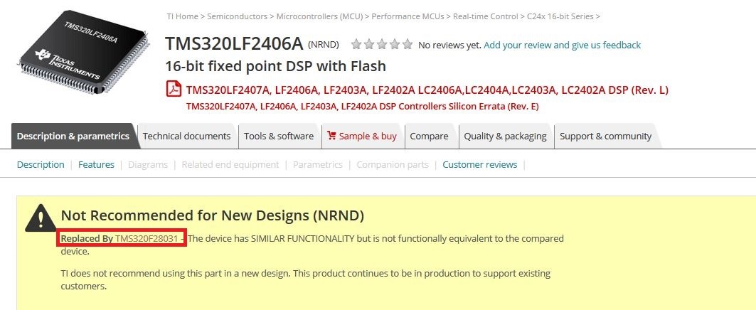

    I understand that TMS320LF2406A is NRND and may not be supported by new tools
    Can i have the TMS320LF2406A replaced by another MCU with same pinout and functionality (which i can program with C2000 gang)

  • Peter did you check with this device for replacement:
    Gautam
  • Yes, i did note that before i purchased the programmer
    The requirement arises from necessity to make changes to an old device (with existing hardware)
    So unless there is another replacement part (F28031 is not direct replacement) i still need ways to program the LF2406A

    As I mentioned in my previous message, C2000 gang programmer doesn't support programming any of F24xx devices (which includes F2406A). This has nothing to do with NRND note in the device webpage. When C2000 gang programmer was developed during some of F28x devices and decision was made not support earlier F24xx devices. In short, C2000 gang programmer never had support for F24xx devices.
    I do understand that you got deceived in buying C2000 gang programmer as it was mentioned in device webpage. If you want to use F2406A device, then I check and see whether TI can cancel the purchase and refund your money. But, if you are considering F2406A for new design, as mentioned in the webpage, I would urge you consider some of the recent devices like F28031 etc. Yes, they might not be pin compactable but they have lot more features and better support infrastructure from TI.

  •  Also I spoke with Manoj about the design and he mentioned that you are looking to use the legacy LF24x devices in your next generation design.  While we have no plans of obsoleting this family we do recommend that you consider a solution such as the F2803x, F2805x, or even the F2806x instead of the LF24x devices because these are not recommended for new designs (NRND).
    Something else we can do to offset the cost of the gang programmer since the misunderstandig was on our end is to provide you with some kits at no cost to offset the cost of the programmer.
    Let me know if this would work for you and sorry for the misunderstanding.
