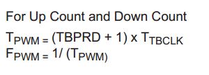

    Here's the formula to calculate PWM Frequency:
    Here, TBCLK can be at the max equal to SYSCLK.
    Hence, if you consider TBPRD as 50 then here's the table:
    TBPRD 50
    TBCLK 1.67E-08
    Tpwm 8.50E-07
    Fpwm 1.18E+06
    I hope this gives you a clear picture.

  • The value of TBPRD can be any (?) number.
    Yes, but this should be decided according to the required step (duty) resolution.
    Summarizing there is not a specification other than the system clock frequency. My project is around 200 kHz and the clock frequency of most C2000 MCUs is above 60 MHz.
    Very true!
    Gautam
