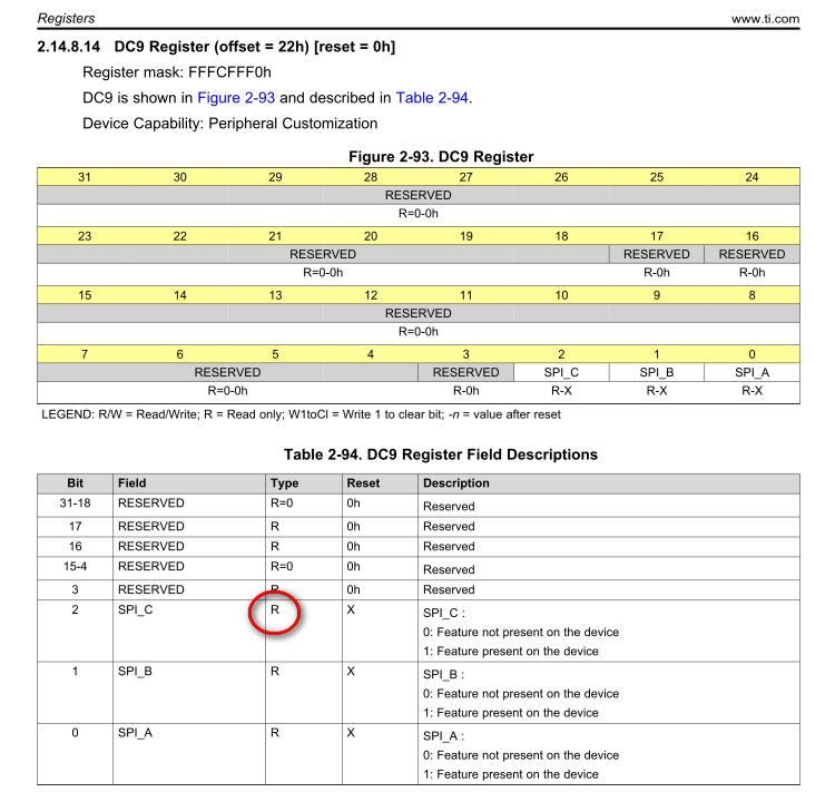

I'm trying to use mmc_F2837xD.c from CONTROLSUITE V110
at line 222 routine "void power_on(void)"
tries to write "DevCfg" register
I read on manual that DevCfgRegs.DC9.bit.SPI_C is read only (page 238 of SPRUHM8C–December 2013–Revised December 2014
