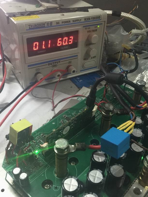

I have bought LVSERVOMTR  (Teknic M-2310P-LN-04K) and DRV8301-69M-KIT  . Control characteristics are alright by evaluating.
Then I designed my circuit board by reference to DRV8301-69M-KIT  .
I need more output current to diver MOSFET,so I use IR2114.I used hall current sensor which range is 40A  to do three-phase current measurement.

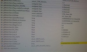

When I used my board to run lab02b,I got Rs = 2.xxx but Ls_q and Ls_d = 6.xxx *e-10. I think it was wrong result.
Now I confirm polarity of the current feedback is correct.I found each of the phases voltage to ground was 8.1V when the code did not perform but ti was 0.8V on DRV8301-69M-KIT . can it lead to the wrong  parameter identification results? Or there are other mistakes?

  • Hello chris
    I think I am in serious trouble,although I have already solved the problem about bootstrap capacitor.
    A new problem has appeared:
    When I run the lab02b with my power board which contains 6 mosfets,Rs = 0.32~0.33,Ls_q = Ls_d = 0.00017~0.00018. These values are correct.
    When I run the lab02b with my power board which contains 48 mosfets,Rs and Ls ware incorrect,and the bus current was 1.1A!(When I disconnect the motor from my board,it was still 1.1A ).
    So I found When mosfet was increased,parameter identification was affected and power losses was huge!
    I did not know when some mosfets in parallel,what went wrong.

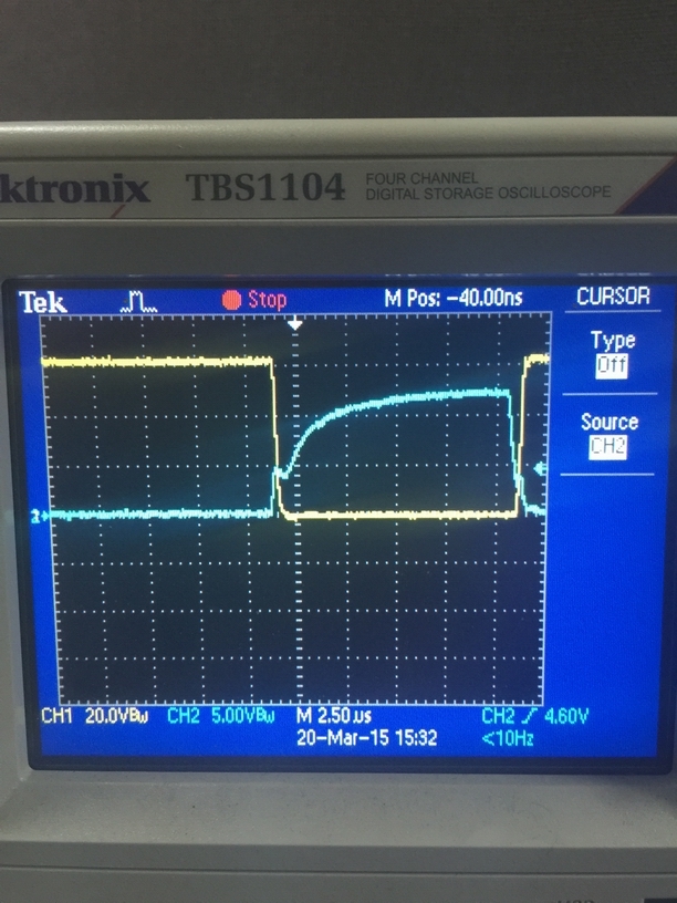

    Some experimental figure,When I run the lab02b with my power board which contains 48 mosfets:
    Completely wrong parameters:
    A huge loss:

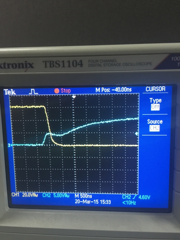

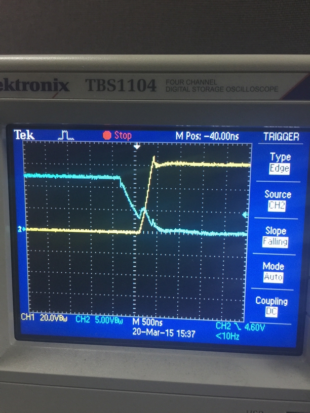

    Vgs and Vds of the upper mosfet (A phase),PWM rising edge:
    Vgs and Vds of the upper mosfet (A phase),PWM failling edge:
    Vgs and Vds of the upper mosfet (A phase),the full figure:
