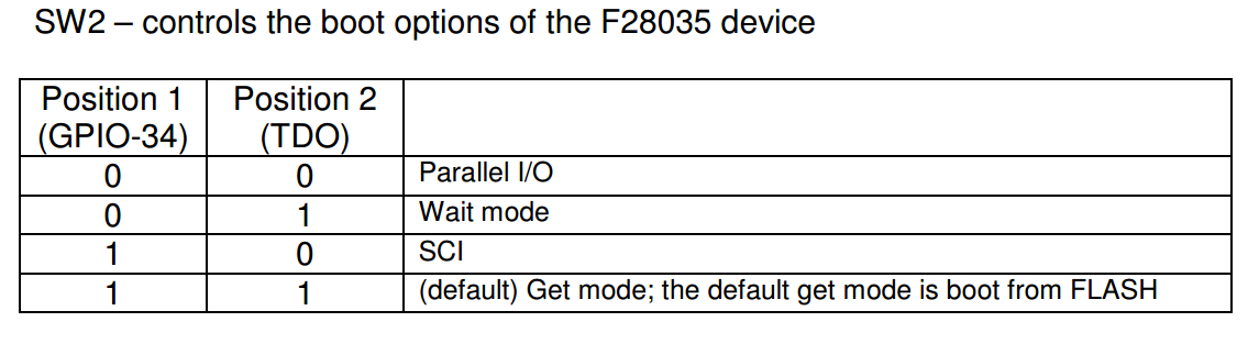

I recently received BLPFC demo kit from TI. But I am not able to setup the communication between kit and GUI provided.
On connecting 12V supply and USB cable, the kit was detected on COM port 8. I changed the baud rate of port 8 to 57600 and also unchecked "boot on connect" option. But still it is not working. XDS driver is already installed and working fine because I have worked with TMDSCNCD28035 control card which has same TMS320F28035 chip on it.
GUI shows following error:
"Please ensure SCI boot jumper is placed or that the target is flashed then try again."
I hope the SCI boot jumper are on the control card only at SW2. Or is there any jumper on the PFC kit which I need to connect.
