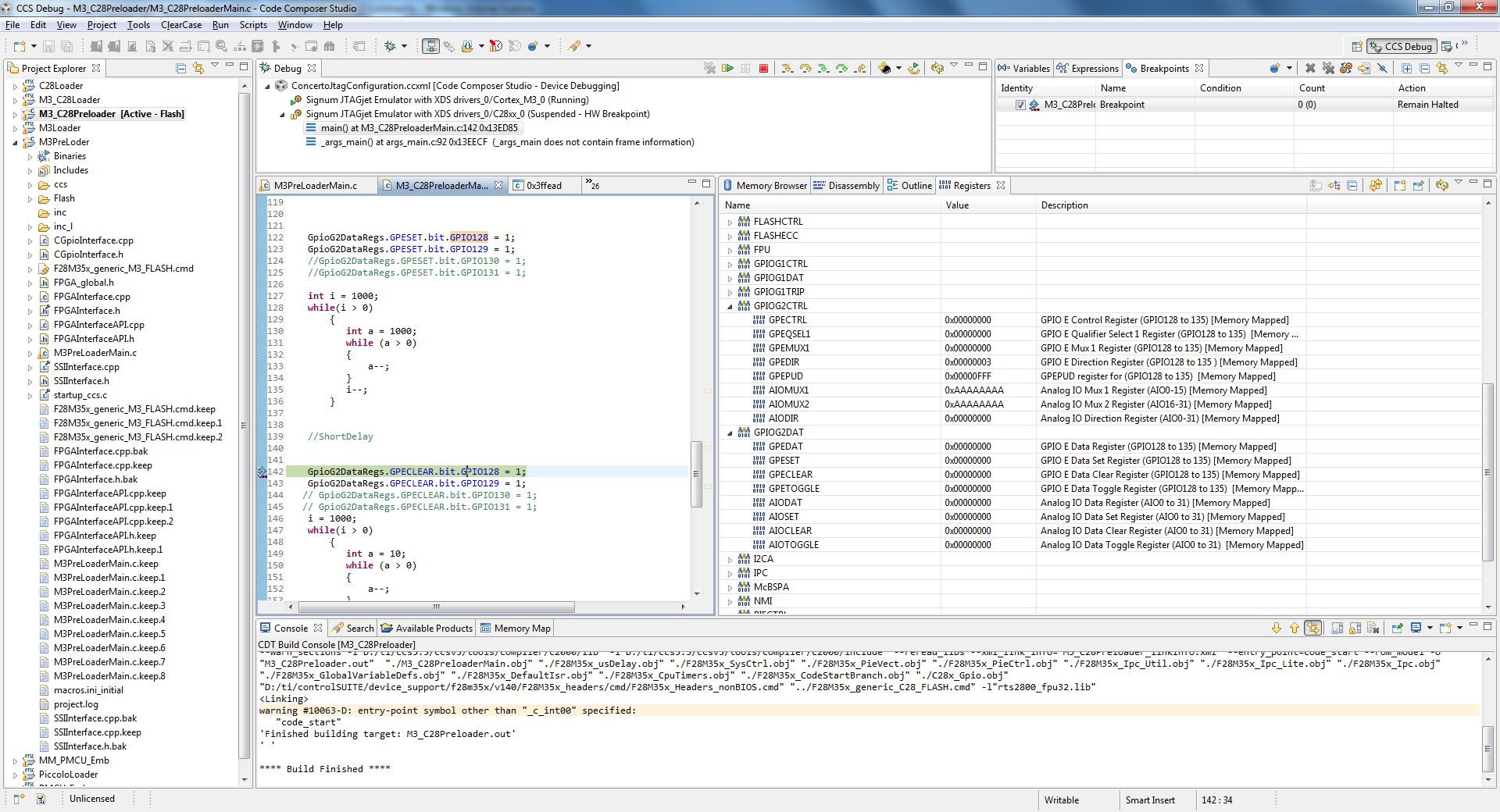

We have to use GPIO 128-135 in concerto C28 (F28M35H52C1). We use all definitions per technical doc, but it doesn't work.

    val = GpioG2DataRegs.GPEDAT.bit.GPIO130;  //read value A2
We don't see any changes in IO by using above commands.
Couls you help ua with? what wrong here?

We tried to comment the last line: GPIOPinConfigureCoreSelect(GPIO_PORTE_BASE, 0xFF, GPIO_PIN_C_CORE_SELECT); , but it didn't affect.
GpioG2DataRegs doesn't changed.
