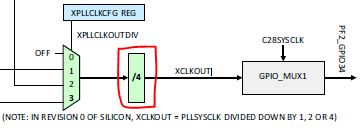

Good evening,
I was using C28SYSCLK on Rev.0 device as XCLKOUT getting 150MHz as maximum frequency and on Rev.B device same configuration gave me 37.5MHz   From 1.13.7.5 of spruh22f.pdf manual I got the explanation. XPLLCLKOUTDIV=1 on Rev0 is PLLSYSCLKC28 and on RevA C28SYSCLK/4. So my question is if it is possible in some way to get 150MHz on XCLKOUT and is the 37.5 MHz maximum frequency we can get on XCLKOUT?.
