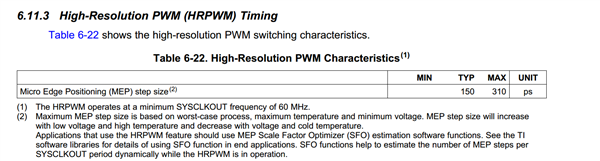

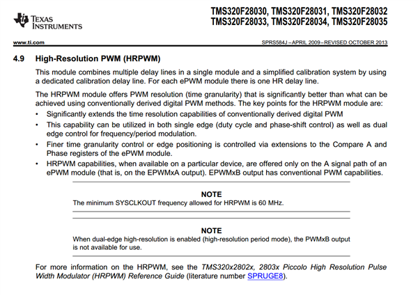

For an induction heating design, i am looking forward for a pwm generator at around 500 khz. Is it possible with C2000 family to create such signal, with frequency step change of 0,5khz or less ?

    This should be possible with devices that have HRPWM.  Some devices to investigate might be F28035, F28069, or F28075.

  • Also, do check the HRPWM user guide or TRM (Technical reference guide) of the particlar controller to get the detailed info on HRPWM peripheral.

    İ made some changes with the example code, i was able to see the pwm signal on the oscilloscope and i was able to change Period and PeriodFine variables via ccs watch window and see the changes on the oscilloscope again. But i have two questions,
    1) frequency is not stable, for example Period=62 and PeriodFine=0x0100, frequency i see on the oscilloscope is changing around 486.5 and 487.1 khz.
    i cancelled UpdateCoarse and UpdateFine in the for(;;) loop, so i am expecting to see a fixed frequency.
    2) Is it possible to make high resolution period and high resolution phase change at the same time, thus i need for my PSFB configuration. I could not find any example about it. Could you please highlight the required steps for this kind of operation
