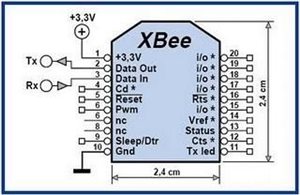

I need to make two C2000 F28027 talk wireless using Zigbee Pro. I cannot find anything helpful on this . Can you provide me with useful links ?
1: I used IDE ( Energia) , connected tx , rx pins of c2000 to that of Zigbee.
J1.3 as rx
J1.4 as tx
Wrote a simple code :

  • Ayushman,
    From your code it looks like you're trying to use the same serial port to talk to the XBee and the serial terminal on your PC. I'm afraid this won't work. If you required a UART connection to the PC, the new F28069M might be a better choice as it has two serial ports and is also supported in Energia.
    Also, there is an XBee library available for Arduino that should work in Energia:
    code.google.com/.../xbee-arduino
