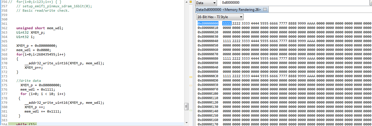

    The following picture is the result after "Emif1Regs.SDRAM_CR.all = 0x00004720" sentence:
    After run the for loop, the memory spaces like this:
    I think all the other memory values should be 0, if we don't write anything to them. but why they have all those strange values?

  • Xiaowei,
    We have used Micron part "48LC4M32B2".
    You are calling function "__addr32_write_uint16" which does a 16bit write (not 32bit) and in every iteration incrementing the address by 2 so it's updating every alternate address with data 0x1111. This is correct. There is no default state for the memory location. So you need to initialize the data in memory with 0x0 to make it 0x0.
    Can you change the data also in loop and see if it's correctly updating the different memory location with different data.
