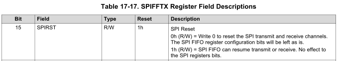

The question is: is there a way to reset SPI peripheral without Disable/Enable clock and reconfigure ?
If I use SPIRST bit in the register SPIFFTX (see page 1914 of SPRUHM8C) SPI behaves in a strange way (see image below).
Can some one explain how this strange behavior ?
