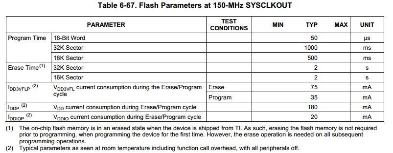

Hello all,
I am looking trough the documentation of the TMS320F28377D, and specifically looking for the current consumption during erase and programming cycles. I could not find these values in either SPRS880C nor in SPRUHM8C. I need these parameters for the design of the power-supply stage.
Could someone provide me the values for these parameters?
Many thanks,
Erik Heuvelman
