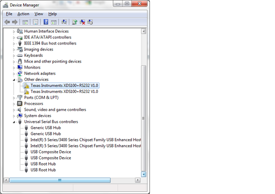

I am struggling with the VCP auto-connection problem already mentioned several times in this forum.
In short: I get the message "VCP auto-connection is enabled for this interface, but there was a problem retrieving COM ports from your system. This may be due to a WMI corruption."
when starting any sample program for my motor development kits with a kit connected. I followed all the suggested solutions in other posts. However, everything looked fine. The device "Texas Instruments XDS100+RS232 V1.0" contains all required functions (TI XDS100 Channel A, TI XDS100 Channel B, USB Serial Port (COM3), USB Composite Device), updating the XDS100 drivers for channel A or B with the TI drivers as suggested by an older post leads to the windows message that the current driver is the same and up to date (FTDI driver from March 18 2011, version 2.8.14.0 with correct windows signature). Furthermore, for XDS100 Channel B, VCP is activated, but not for Channel A, as described in other posts.
The virtual COM3 is configured as follows: 9600 bos, 8 data bits, no parity, 1 stop bit, no flow control.
The only , that the device manager lists "BCM20702A0" as unknown device. However, I do not know if this is a TI device or related to it.
What do you suggest?
