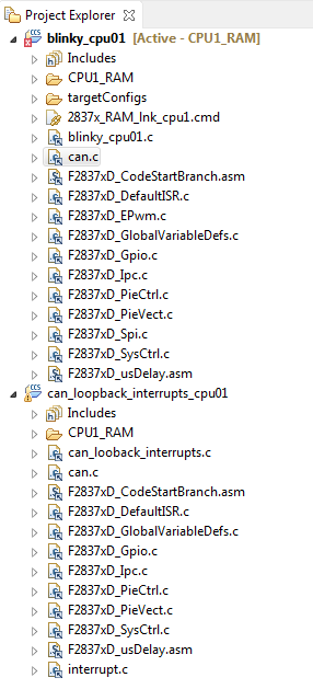

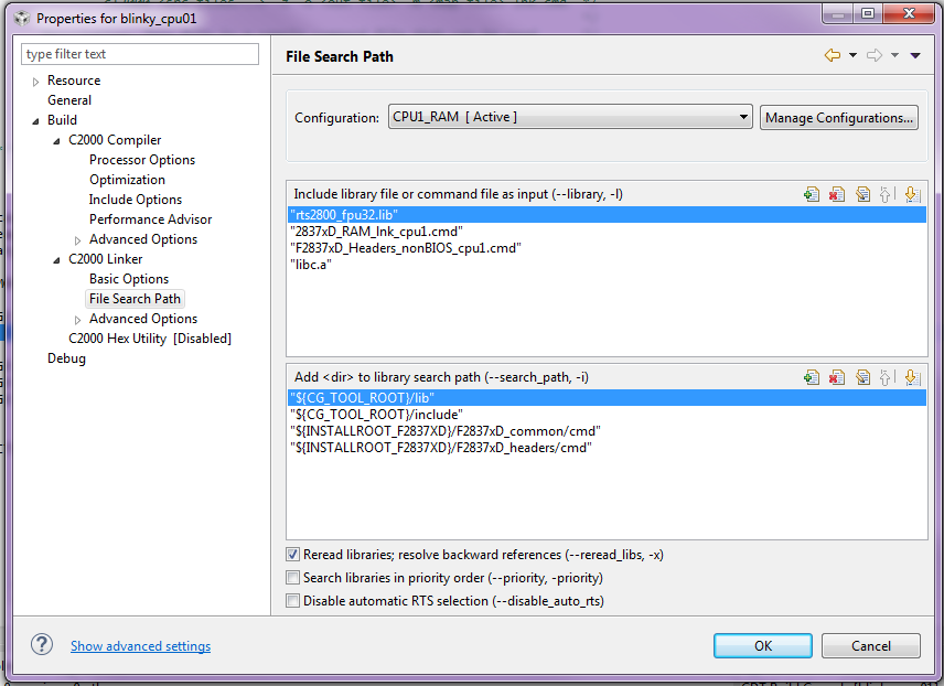

I hope someone can help me. I am trying to build the example project "blinky_cpu01c" from the controlSuite.
I made the following settings:
When I try to build the RAM Configuration I get 63 Errors :(  MEMORY RANGE HAS ALREADY BEEN SPECIFIED.
I did not change the linker settings.

<Linking>
"C:/ti/controlSUITE/device_support/F2837xD/v140/F2837xD_common/cmd/2837xD_RAM_lnk_cpu1.cmd", line 7: error #10263:
   BEGIN memory range has already been specified
"C:/ti/controlSUITE/device_support/F2837xD/v140/F2837xD_common/cmd/2837xD_RAM_lnk_cpu1.cmd", line 7: error #10264:
   BEGIN memory range overlaps existing memory range BEGIN
"C:/ti/controlSUITE/device_support/F2837xD/v140/F2837xD_common/cmd/2837xD_RAM_lnk_cpu1.cmd", line 8: error #10263:
   RAMM0 memory range has already been specified

Can please someone help me?
  • Seems that more than one linker cmd file is active...
    Try to remove the linker command entry on your first screenshot, leave this setting empty.
    Roger
  • That did it!!! Thank you very much!! 1000 thumbs up. "F2837xD_RAM_lnk_cpu1.cmd" was executed twice. I simply removed it from the list (second screenshot)
  • Hi Werner,
    The importing of the project seems to have gone wrong. I just checked with mine and importing the project works really well.
    You don't have to do any setting after importing the project. You can directly build the project.
    Gautam
  • Hi Gautam,
    If I just import the project and build it, it works fine. But I want to build the project in RAM and not
    in FLASH. However I am happy with the solution :)
    Thank you very much.
  • One problem solved, annother occurs :(
    I just wanted to implement the can.c from the controlSUITE into the blinky example.
    I opened both projects and copied the can.c into my blinky example.
    For SPI.c and EPwm.c this worked fine. Although I included the can.h as well as the
    hw_can.h in my blinky, I cannot use the can functions. I get following errors:
    'Building target: blinky_cpu01.out'
    'Invoking: C2000 Linker'
    "C:/ti/ccsv6/tools/compiler/ti-cgt-c2000_6.4.2/bin/cl2000" -v28 -ml -mt --cla_support=cla1 --float_support=fpu32 --tmu_support=tmu0 --vcu_support=vcu2 -g --define=CPU1 --diag_warning=225 --display_error_number --diag_suppress=10063 -z -m"blinky_cpu01.map" --stack_size=0x100 --warn_sections -i"C:/ti/ccsv6/tools/compiler/ti-cgt-c2000_6.4.2/lib" -i"C:/ti/ccsv6/tools/compiler/ti-cgt-c2000_6.4.2/include" -i"C:/Users/motz.werner/Desktop/DSP/F2837xD_common/cmd" -i"C:/Users/motz.werner/Desktop/DSP/F2837xD_headers/cmd" --reread_libs --display_error_number --xml_link_info="blinky_cpu01_linkInfo.xml" --entry_point=code_start --rom_model -o "blinky_cpu01.out" "./F2837xD_CodeStartBranch.obj" "./F2837xD_DefaultISR.obj" "./F2837xD_EPwm.obj" "./F2837xD_GlobalVariableDefs.obj" "./F2837xD_Gpio.obj" "./F2837xD_Ipc.obj" "./F2837xD_PieCtrl.obj" "./F2837xD_PieVect.obj" "./F2837xD_Spi.obj" "./F2837xD_SysCtrl.obj" "./F2837xD_usDelay.obj" "./blinky_cpu01.obj" "./can.obj" "../2837x_RAM_lnk_cpu1.cmd" -l"rts2800_fpu32.lib" -l"F2837xD_Headers_nonBIOS_cpu1.cmd" -l"libc.a"
    <Linking>
    undefined first referenced
    symbol in file
    _IntDisable ./can.obj
    _IntEnable ./can.obj
    _IntRegister ./can.obj
    _IntUnregister ./can.obj
    error #10234-D: unresolved symbols remain
    error #10010: errors encountered during linking; "blinky_cpu01.out" not built
    >> Compilation failure
    gmake: *** [blinky_cpu01.out] Error 1
    gmake: Target `all' not remade because of errors.
    **** Build Finished ****
    Wat do I have to do, to use the can functions from can.c in my blinky?
    I am looking forward to your answer.
  • If you're using interrupts then did you try including interrupt.c ?
  • You were right. The interrupt.c was missing!! Thank you very much for the fast help. This forum is awesome.
