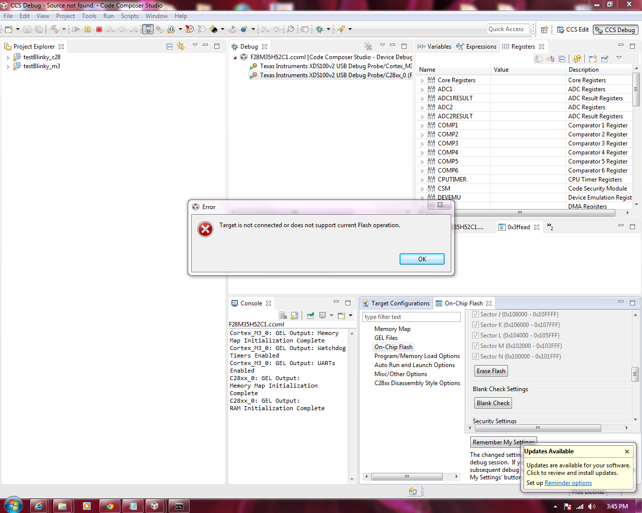

    I was able to erase the entire flash of the C28 and M3 following the instructions above. Once I tried to change the program and reload the C28 I received an error. I then tried to erase the flash again and reload everything and I got the error you can see in the screenshot below. Ill list the order of steps I tried just in case I did something out of order.
    • Launch target configuration
    • Connect both M3 and C28
    • Put C28 and M3 in free run mode
    • Reset both M3 and C28
    • Erase M3 flash (works)
    • Erase C28 flash (doesn’t work)

  • Joshua,
    1) Try below flow:
    Reset M3 and then C28
    Put M3 and C28x in free run mode
    Erase M3 flash (works) and load code to M3 Flash
    Erase C28 flash and load code to C28x Flash
    Resume the execution on M3
    Resume the execution on C28x
    2) Check your linker command file/map file to make sure that you are not allocating any sections to unimplemented addresses.
    3) Are you programming anything in the password locations? If yes, are you unlocking before the next round of erase/program?
    Thanks and regards,
    Vamsi
