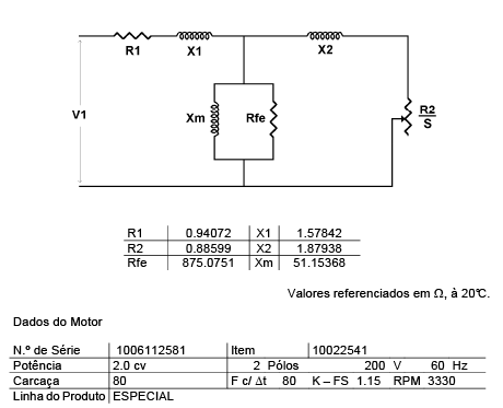

I'm having some trouble running motorware lab 5e. I have a high voltage kit (TMDSHVMTRINSPIN) with a TMS320F28069M control card and I need to control the speed of a treadmill without and encoder.
I've already updated my motor parameters according to the data provided by my supplier as you can see in the image attached and I calculated these values based on section 4.8 from user's guide.

  • Vitor,
    You mentioned that you bypassed lab 2.  I would recommend that you go back and run that lab.  Motor datasheets are often off by 10-20% and with sensorless control this difference can be critical.
    My advice would be to run lab 02a in order to get your motor parameters before trying the speed control in lab 05e.
  • Hi Adam,
    I expressed myself badly. Initially I did the labs 2 to 5e but since it didn't work I asked for my supplier for the datasheet parameters.
    I discovered something that improved greatly the response of the kit. I changed the TripRef of the kit by changing the position on the MAIN-J7 jumper, placing it in the middle pin and the left pin (toward control card) and adjusted the trimpot to set the voltage to 3.3V.
    In the kit, however, it instructed to place such jumper in the middle pin and the right pin (towards capacitors).
    After doing so, I could set the USER_MOTOR_MAX_CURRENT parameter to 8A and higher without causing the system to stop, unlike before and got much more torque when applying load.
    I tried the sensorless control with the parameters from the datasheet and from the identification process from lab 2a, but didn't notice any difference.
