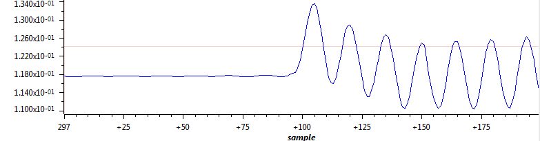

I am trying to enable online Rs-recalibration in order to estimate the motor temperature. I am using proj_lab07.  When I set the speed to 1kRPM, the Rs_online variable is nice and stable. However, when I set the speed to 2 kRPM, the RsOnline_Ohm value starts to oscillate. I've logged RsOnline to show this; see the graph below. The first half is taken with 1kRPM; at around sample +90 I've changed the speed to 2kRPM.
Is there anything I can do to stop the oscillating of RsOnline at higher RPMs?

    Is the speed stable at 2 KRPM during these samples or is the motor still accelerating?
  • Thank you. The speed at the beginning of the graph is stable at 1 kRPM. At about sample +90 I changed the speed to 2 kRPM. A stable 2 kRPM was definitely reached before sample +125.

    Does it do the same when you decelerate to say 500 RPM?
  • At 500 RPM the measurements are stable.

    what does your Flux value look like at 500, 1KRPM, and 2KRPM? Is the control itself still stable? It is just the Rs that is oscillating?

    The flux values remain pretty stable. The value is about 0.009 (varying slightly across different speeds) and fluctuates less than 0.0001 peak-peak.
    When using values from user.h, the bias values in gMotorVars are identical to the values set in user.h. We have measured the amplitude of the sine wave we see on RsOnline in three cases, all at 1 kRPM and with a PWM-frequency of 45 kHz:
    • Using the original bias values from user.h: 0.012 Ohm peak-peak
    • Using enableOffsetcalc: 0.003 Ohm peak-peak
    • Copying the values from the enableOffsetcalc offset measurements into user.h and using these values: 0.003 Ohm peak-peak
    Apparently the bias values we had specified in user.h were slightly off (the values were off by less than 0.02), and this somehow caused RsOnline measurement to become less stable when not using enableOffsetcalc.
